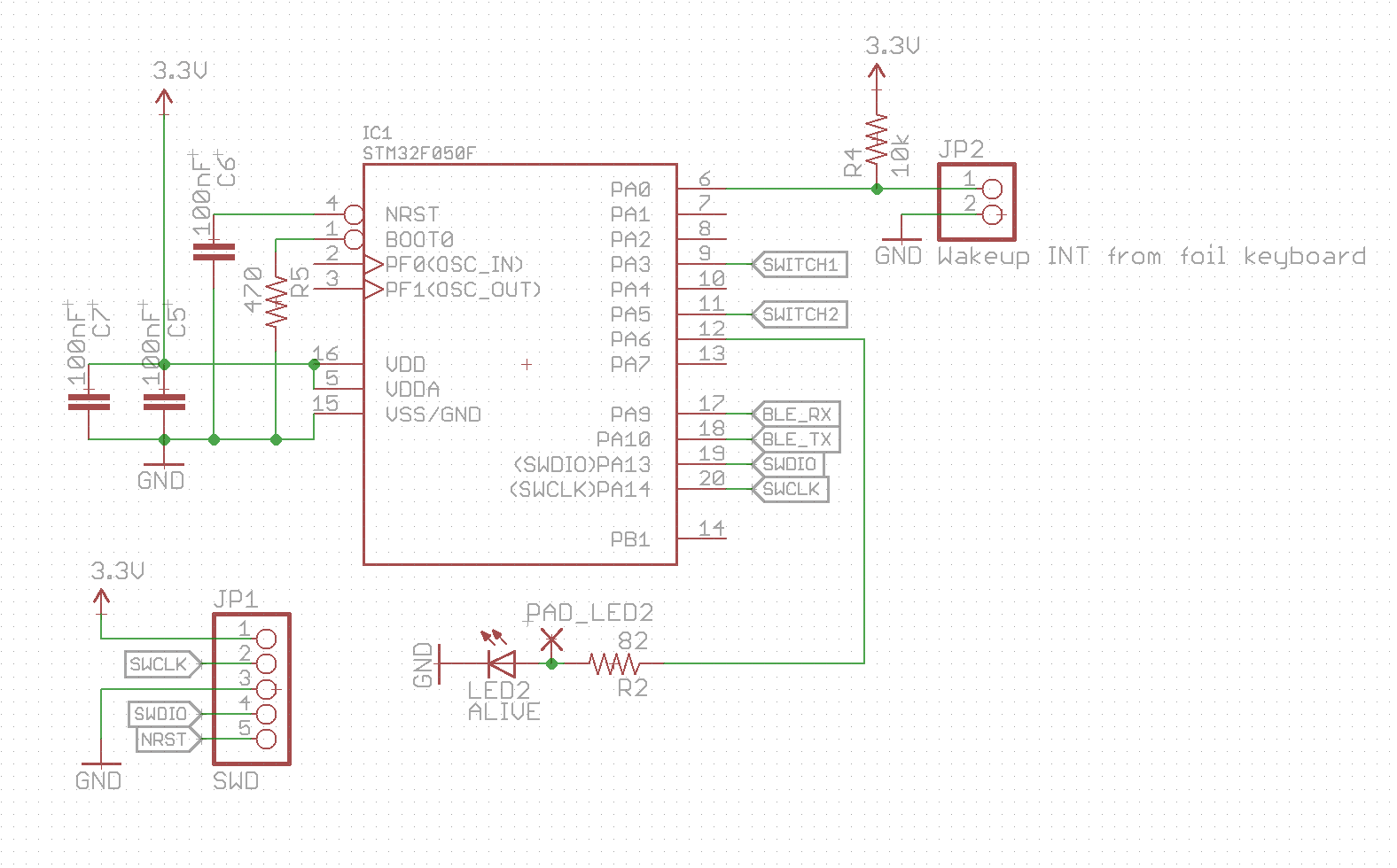

Hey everyone,
just switched from STM32F0-Discovery to the own build PCB which holds a STM32F031 (Actually ST labeled it STM32F050 but ST-Link Utility tells me STM32F031 is the name). I was able to compile and flash the code that was written for the Discovery board, but nothing works.
Am I having the same issue and how can I switch the MCUs? I dived into the GPIO code, but was confused with the existing configurations. I have just updated the code from SVN repo, so this should be latest.
Thanks for any help.

Re: STM32F050F4 Problem
Thanks, Giovanni. Done that.
Actually nothing happens. I have a LED connected against GND on PA6 and want the blinker thread to let it ... blink. I only have 1.7V continously at this pin. I am some kind of angry-blind ...Would somebody be so kind and have a look at my code and schematics? That'll be awesome. I can't see any more hints here...
Also, I have created and use a linker script based on the STM32F051 script and reduced stacks to 100, RAM to 2k and FLASH to 32k.
Thanks for any advice.
Cheers
Stefan
Cheers
Stefan

- stm32f031_schematic.png (20.38 KiB) Viewed 5399 times
