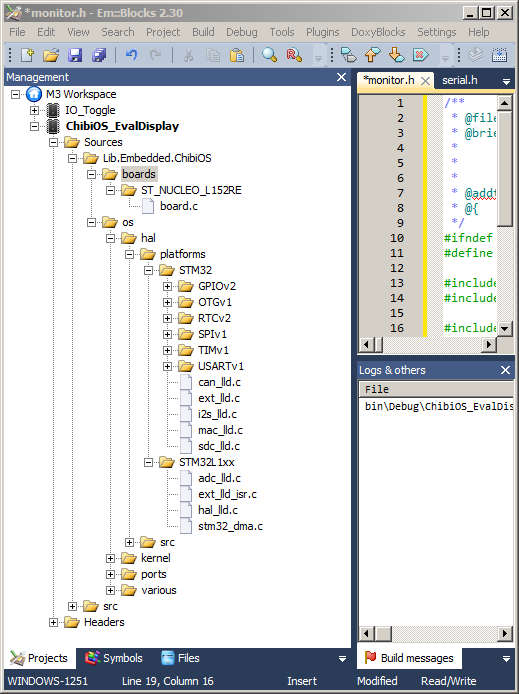

by Chudik
Dvor_nik
Unfortunately Em::Blocks does not have configuration utility.
I analyzed project created by emblocks (author) and created my first ChibiOS project based on it and on Tectu's project as well. With some help from Giovanni, of course :)
I'm using project management like in the picture below
emblocks ptoject.PNG (57.1 KiB) Viewed 13138 times
Please, note:
- boards directory includes the board description files (.c & .h)
- os->hal->platforms includes all required drivers. Note, that if in Linker settings you check "Remove unused sectors" item, they actually won't be used in the project and will not increase code size either.
If you need I can attach here my project, where you will need to make changes, related to your board (including LED and serial port) and your processor.
P.S. Your nick looks like Russian. Is it? :-)
