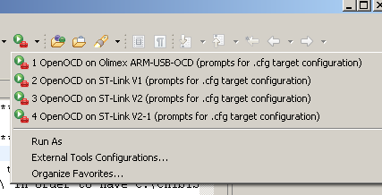

Sorry but I'm not familiar with OpenOCD ... How do I load C:\ChibiStudio\tools\openocd\scripts\target\stm32f4x_stlink.cfg ?
Using command line ? But how do I tell ChibiStudio to use it ?
Thank you for the help.
Re: [HELP] iNemo M1 debug
In the toolbar there is a menu that allows to launch external applications, OOCD is there, after launch it will prompt for the script file.
