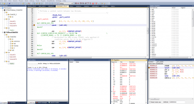

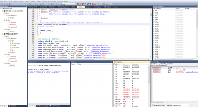

You can see the STM32F4's CPU registers and the disassembly just before the exception, and after it.
The vpush instruction attempts to move the FPU registers (s16 - s31) to the stack, but the next instruction branches over to the unhanded exception handler instead.
For some reason, R7 contains something at this point. Does anyone know what could cause this to happen?
