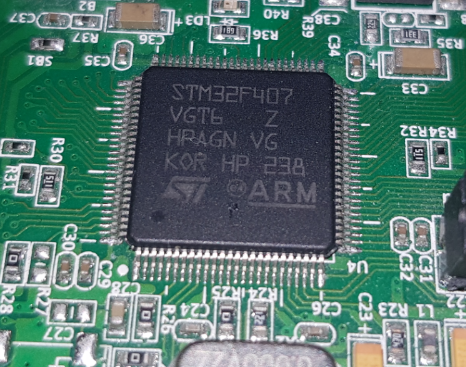

The MCUs has the same revision-stamping ( Z ) but different date codes. 238 on the working board, 220 on the non-working board.
All board markings except the serialnumber adds up ( sernr. 213021424 vs 213010138 )

Just a quick follow-up, if someone stumbles into the same problem.
It was indeed a faulty MCU.
I replaced the chip today and everything is up and running.
