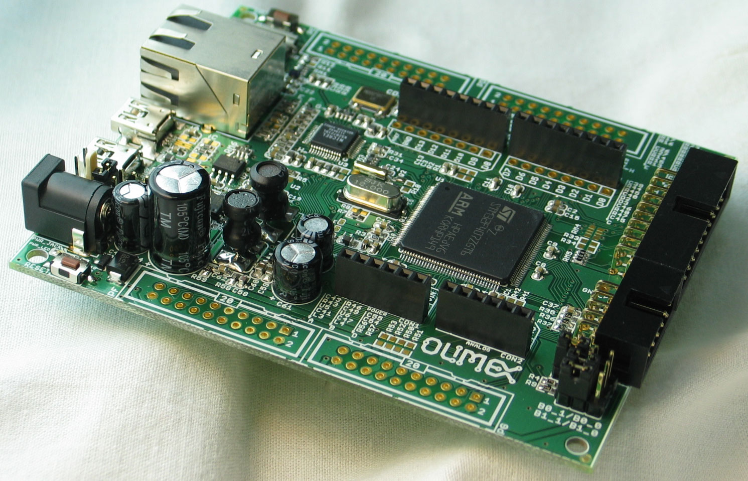

Tsvetan from Olimex sent me one of the two prototypes of the new board STM32-E407. Even if it is a prototype it is "final" and looks very good, no added wiring or other adjustments.
The board is very interesting, it has an STM32F407, on board Ethernet and the two OTG ports, everything else is available for experiments. It also has Arduino-like connectors, I will write a review.

I am studying the schematic and the board is really promising:
- No pin conflicts.
- Power protection.
- First step down converter from 6V-16V to 5V and second step down converter from 5V to 3.3V.
- Options to be powered via USB.
- SD connector connected to SDIO.
- Full JTAG port.
- Ethernet with external oscillator for the KS8721 PHY.
- Two full OTG ports.
- User button and user LED.
- Small board and clean layout
And this is the board:

Giovanni wrote:- No pin conflicts.
- Full JTAG port.
Those are result of using 144 pin version, instead of 100 pin as in Discovery board :mrgreen:
