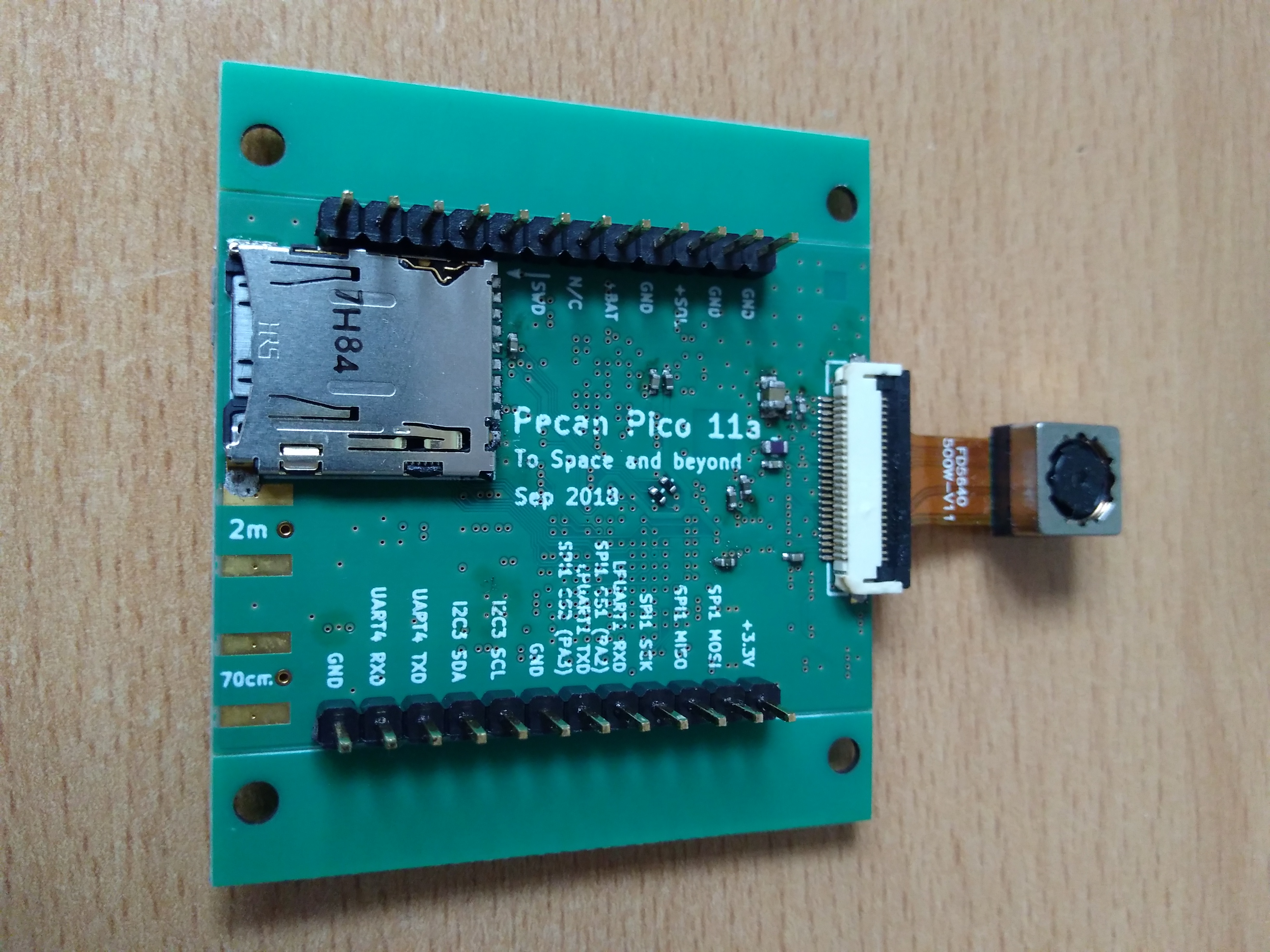

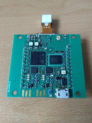

Even though I'm often asked if I sell those boards, I'm unable to do so while those boards are all handcrafted and it takes a friend and me around one day to build a single unit with our BBQ soldering technique (aka. reflow soldering). Here's a video of it:

This board is wider so it may fit into a sliding case. The excess can be broken off if not needed. This board has no GPS receiver while we were still waiting for that component to arrive at that time. It also has no GPS antenna fitted, because an external antenna can be connected by the IPEX connector.

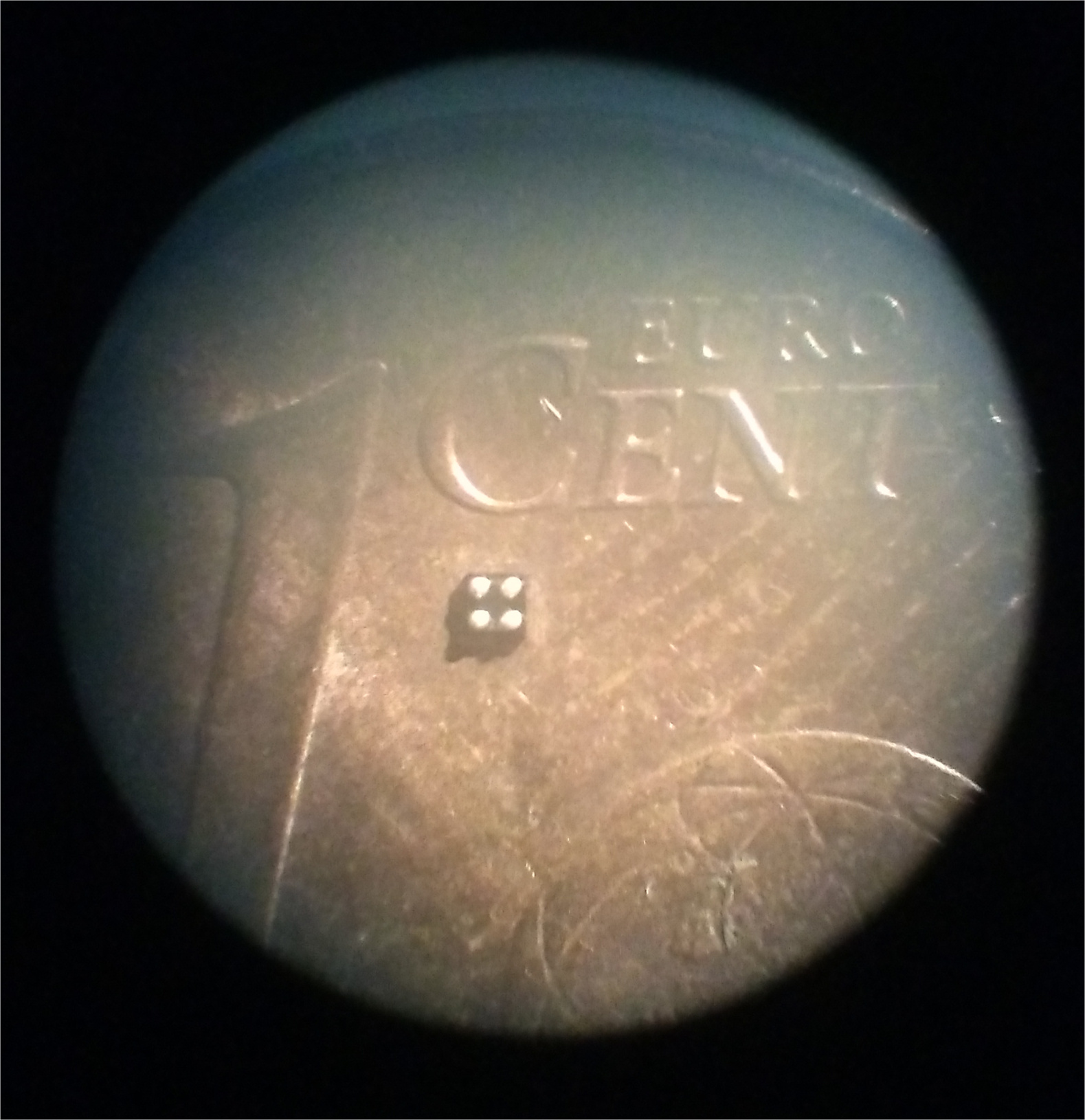

Our smallest component (a power switch) is literally a nightmare to solder. it has a pitch of 0.35mm. It took us 2 hours to fix solder errors with those components. But therefore we got more experience with those parts.
