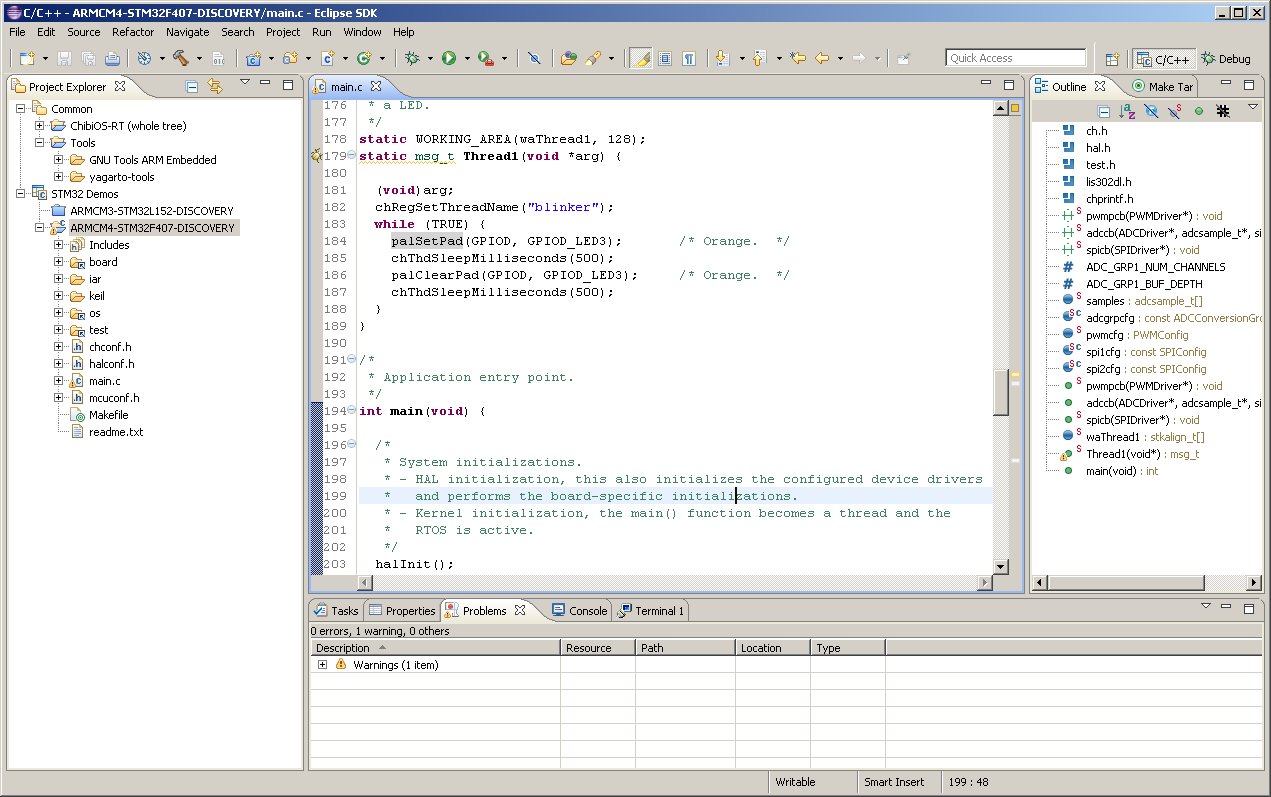

Just a note, I am playing with Eclipse Juno and it looks good, apparently even faster than its predecessors, or at least it feels faster.
I just had an idea to pack it with the newest ARM toolchain, all the usual plugins, do all the boring settings, add ChibiOS, import some projects into a workspace nicely arranged in Working Sets and finally zip the whole thing and slap a "ChibiToolchain 1.0" label on it.
A lot of people is still having problems in setting up the Eclipse toolchain and a pre-configured package would make life easier for them.
The current ChibiToolchain is composed of:
- Eclipse Juno 4.2 classic (http://www.eclipse.org) with the following
  optional components installed:
  - Eclipse CDT 8.1.0.
  - C/C++ GDB Hardware Debugging 7.0.0.
  - Target Management Terminal 3.3.0.
    - Serial Connector plugin (http://rxtx.qbang.org/eclipse).
  - ChibiOS debug plugin 1.0.8.
  - Embedded Systems Register View plugin 0.2.1.90
    (http://sourceforge.net/projects/embsysregview/).
- GCC ARM toolchain (https://launchpad.net/gcc-arm-embedded)
  gcc-arm-none-eabi-4_6-2012q2-20120614.
- YAGARTO Tools (http://www.yagarto.de).
- ChibiOS/RT 2.4.1.
This is a screenshot of how it looks so far:
I have to find a way to place a pre-configured OpenOCD in it.
The only problem is that I don't know if my hosting will forgive me this 400MB download, it is supposed to be "unlimited" but...

ChibiOS is a directory inside there, it can be replaced. From a "normal user" point of view probably the latest stable makes more sense. Advanced user will just put there the SVN checkout and update at will.

It is shaping up nicely, probably in the evening I will upload a first version for review.
This is also an chance for me to do all the small improvements I already wanted to do to my environment and never had time to do.
Another advantage should be less effort in support if everybody is using the same "certified" stuff.
I have one doubt however, I am setting up everything for a 32bits Windows OS, will it work also in 64bits setups? I am unable to test this because my idea is to stay with WinXP as long as possible.
