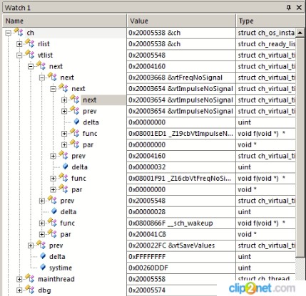

This happenes because one of my virtual timers have NEXT pointer is pointed to itself:
I do not understand how it hapens. If I set the code optimizations to off or switch on the debug options of the ChibiOS the problem is disappere and the program work two days without the crash.

First time the problem was in that the virtual timer "was lost" - I wait it and it did not fired. After some modifications the failure occuring in IRQ, after that in thread. But all time it is happened with virtual timers system.
The new, what I never used before in this project - it is that I used STM Peripheral Library to setup special mode of the TIM. May be it corrupt somthing. But Why it is not reproduced in debug mode.
