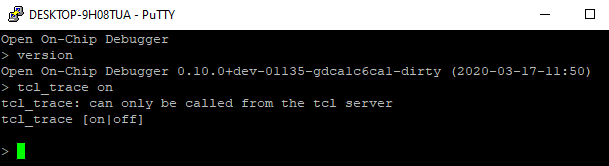

Are there any suggestions on how to send to OpenOCD the "tcl_trace on" command via ChibiStudio? A more detailed explanation is below.

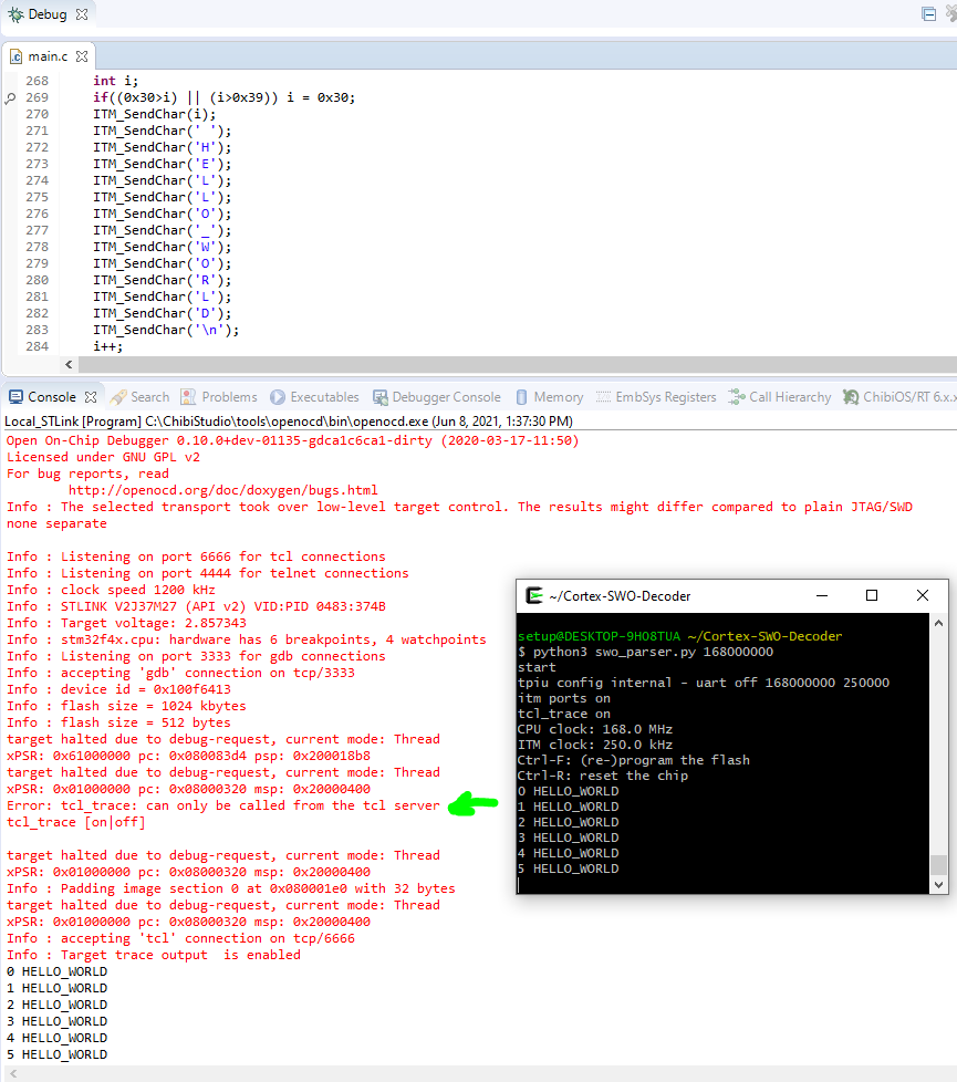

I've made progress. I can get messages to display in a terminal. However I'm currently getting the below error message. I'm also trying to remove some annoying steps in this process.
Error: tcl_trace: can only be called from the tcl server
tcl_trace [on|off]
I get beyond this error message by using Cygwin to launch the below python3 script.
https://github.com/z4yx/Cortex-SWO-Decoder
This script connects to tcl and sends the "tcl_trace on" command. Then I see the message printed to the terminal as shown in the attached picture.

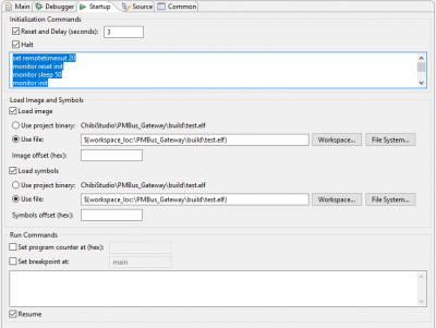

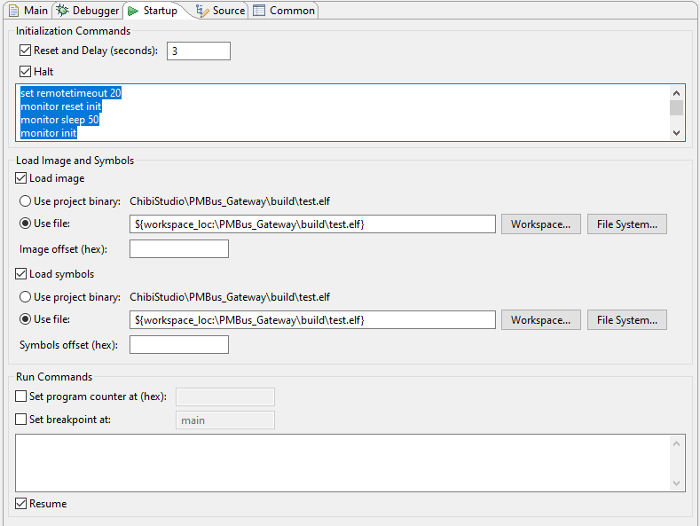

My OCD launcher contains the below commands.
Here's a snippet of the commands. Take note the use of "monitor" to attempt to send the "tcl_trace on" command which produces the above error message.
set remotetimeout 20
monitor reset init
monitor sleep 50
monitor init
monitor tpiu config internal - uart off 168000000 250000
monitor itm ports on
monitor tcl_trace on
Is there some way to send the "tcl_trace on" command via eclipse to OCD?
Re: ITM data via OCD mechanism
You can use the terminal and connect to the command port of OpenOCD, 4444 if I remember well, you can give the command there.

Post by kb1gtt »
The telnet port is 4444, which is the port that is providing the error message and refusing to allow this particular tcl command. It appears the other tcl commands are OK over 4444, but this command is not being allowed over telnet. Instead I need to use the tcl port, which is 6666. From the python script, it appears the below is the important snippet.

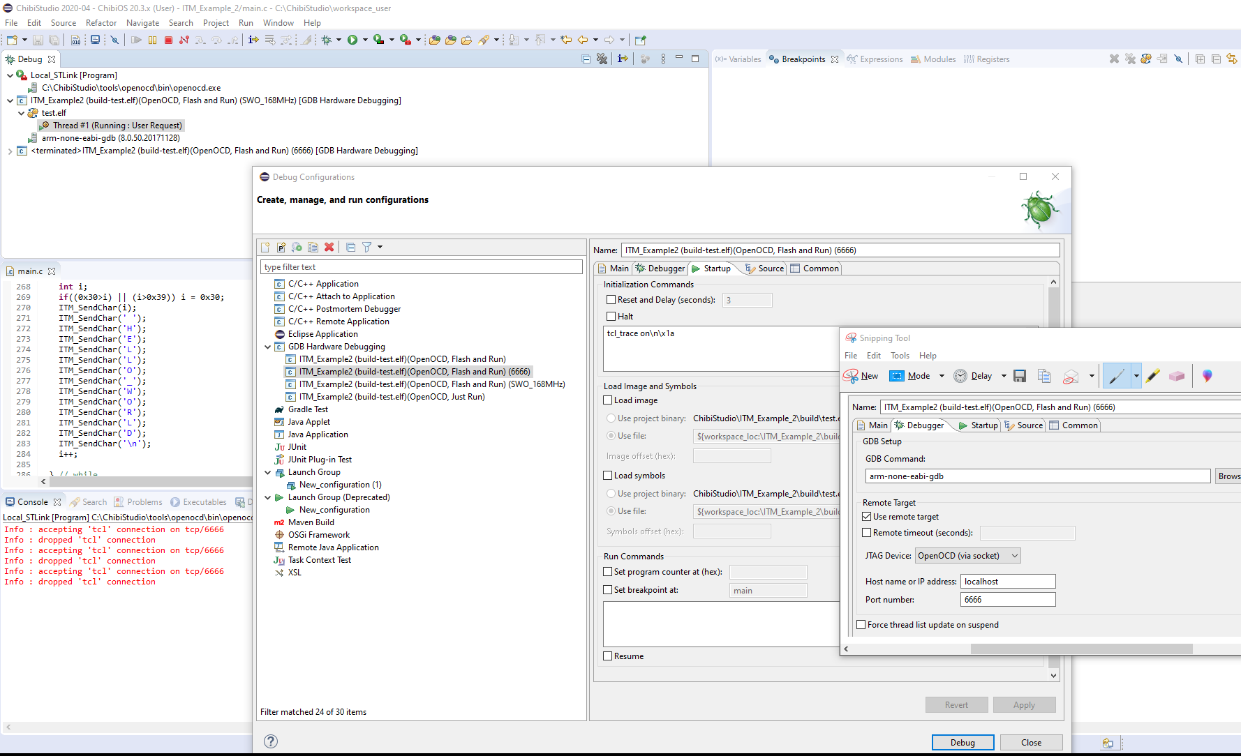

I tried the below, and several variants of the below. It appears that eclipse is opening the port, and perhaps even sending the commands that I typed. However it appears I am not sending the correct set of characters. I have not yet gotten the telnet port to acknowledge that tcl trace has been activated. I suspect that I'm not sending the '\n\x1a correctly. I'm currently trying to figure out how to send \n\r, and even the standard line feed carriage return is being elusive right now. Perhaps I need a / or something like that to break it out. I'm not sure and I'm trying to hack my way through it.
Suggestions on how to send \n\r or '\n\x1a are welcome :)

Post by kb1gtt »
It appears that I can only launch via tcl server. The attached picture was putty from localhost:4444 and after eclipse OCD was started.
It appears I need to connect to port 6666 and send the command. However it appears I need to also send the \n\x1a or tcl server does not process the request.
