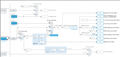

I have a STM32F411CE (blackpill Board) with HSE=25MHz.
I selected M=15, N=144, P=4, Q=5, AHBP=1, APB1=2, APB2=1 which gives 60MHz System Clock and 48MHz USB Clock.
I've got the Error:

Never mind.
I found a solution with:
M=25, N=192, P=2, Q=4 which gives 96MHz System Clock and no error.
