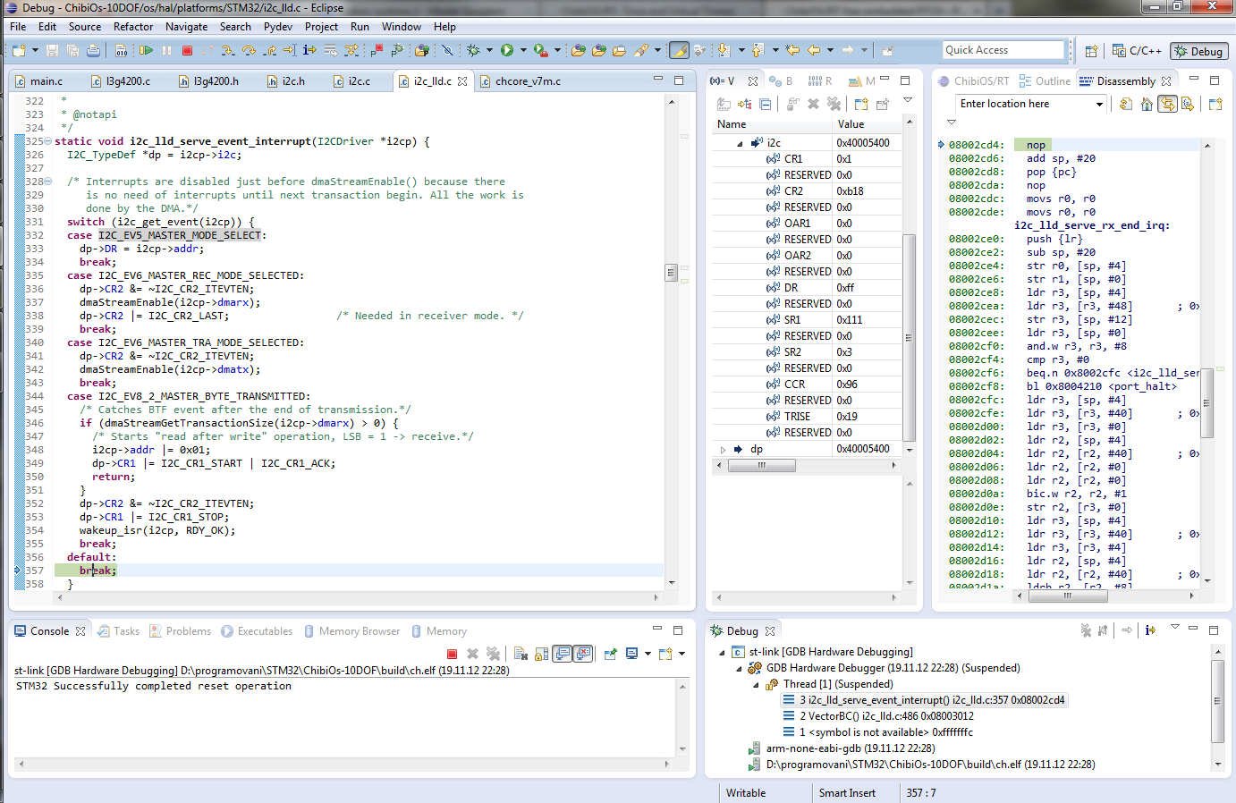

I am testing I2C error recovery (pulling SDA to zero externally - simulated noise) and I am using this code to read data from I2C each 500 ms:
void getL3G4200GyroData(L3G4200Handle *handle, L3G4200GyroData *data){
   uint8_t reg_addr = L3G4200_GYRO_DATA;
   msg_t msg = i2cMasterTransmitTimeout(handle->i2cd, L3G4200_I2C_ADDRESS, &reg_addr, 1, (uint8_t*)data, 6, I2C_TIMEOUT);
   if (msg!=RDY_OK) {
      chprintf((BaseChannel *)&SD2, "I2C failed");
      i2cStop(&I2CD1);
      I2C1->CR1 |= I2C_CR1_SWRST;
      i2cStart(&I2CD1, &i2cCFG);
Sometimes the i2cMasterTransmitTimeout function returns error as I expected, but sometimes the MCU gets stuck in I2C ISR. This stuck state of I2C is captured on attached debug screenshot. I think that i2c_lld_serve_event_interrupt() function should include some error handling options. In error state there is set BERR bit in I2C_SR1 register.

As the i2c_lld_serve_event_interrupt() function doesn't perform any action to clean this bit, the interrupt is fired again and again. ITERREN in I2C_CR2 is set and refman says:
