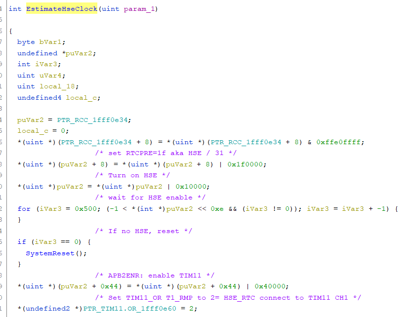

Thanks for the hint, I saw that note in the reference manual, but figured the LSI jump would be easier as I saw it suggested somewhere else. I reverse engineered the ST F407 bootloader a bit, and they are indeed using TIM11, not TIM5 to do the HSE measurement for USB DFU.
RTCPRE is configured to /31, TIM11 is enabled, and TIM11_OR is set to remap ch1 to HSE_RTC.
Here it is in Ghidra:
In our case, TIM11 would run at 168MHz, so the expected range of counts for 4-24MHz crystals would be 1302 counts for 4mhz, 651 counts for 8MHz, and 217 counts for 24MHz, which is plenty of resolution to correctly identify the crystal, especially if multiple capture periods are observed.
