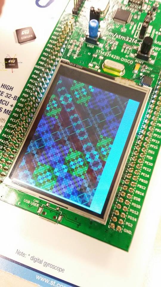

Voilà , first screenshot of a meaningful texture displayed through the LTDC driver
I have to figure out why the texture is shifted. There could be some inconsistencies with the computation of LCD offsets (front-/back-porch) or similar things. I'll inspect the ST demo to see where I'm doing it wrong.
- XOR texture with Wolf3D palette
- 1450218_202156143306028_2110725575_n.jpg (98.83 KiB) Viewed 9032 times

Good work! Happy to see the first usable HAL in action on my board
