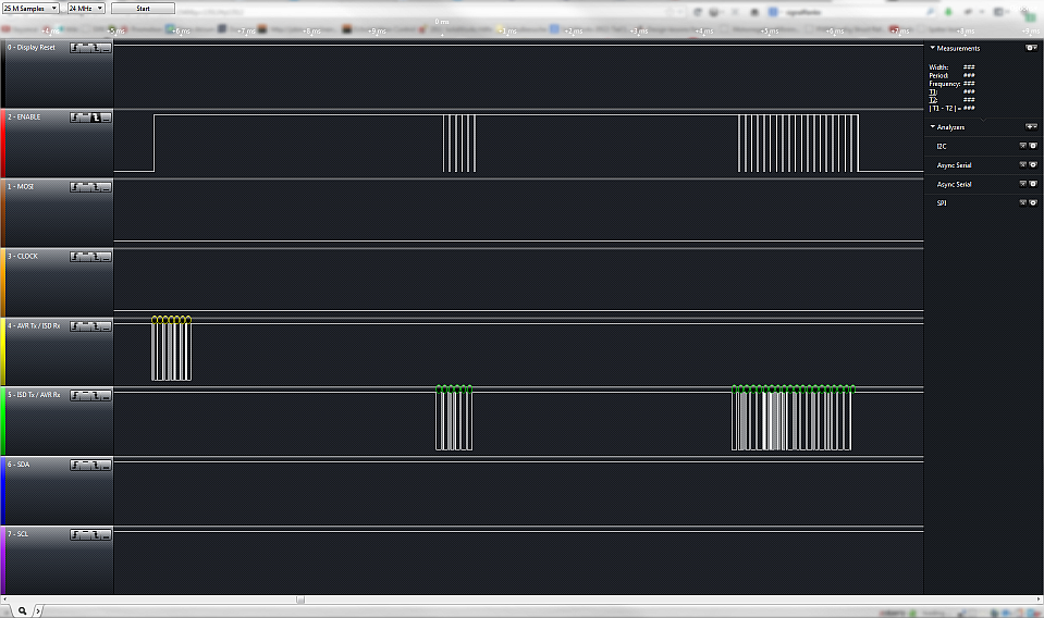

using a BLE112 bluetooth low energy device at my STM32F0 Discovery UART@115000baud I have some trouble somtimes to capture the events if they come quickly each one after another.
I appended a saleae screen where you see a command sent from STM32 at first and the ack from the BLE device. Just 4ms after this the BLE event throws an event. Sometimes my UART handler gets that and sometimes not...

Saleae screenshot of UART events (BLE TX up, STM32 RX low)

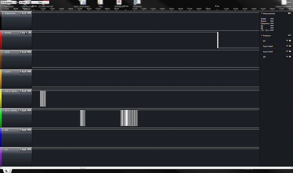

I added a
palTogglePad(INDICATE_PORT, INDICATE_PIN);
(called ENABLE in Saleae screenshot) command everytime a character gets read from the queue in my UART listener to find out more about the timings. What I wanted to see was an edge on the scope directly right after one byte has been seen on the UART Rx line. What I find most of the time is that several Milliseconds after the last byte has been seen on the UART Rx line reading from the queue seems to take place. I added a screenshot.
Why is this behaviour?
Saleae screenshot
Saleae screenshot

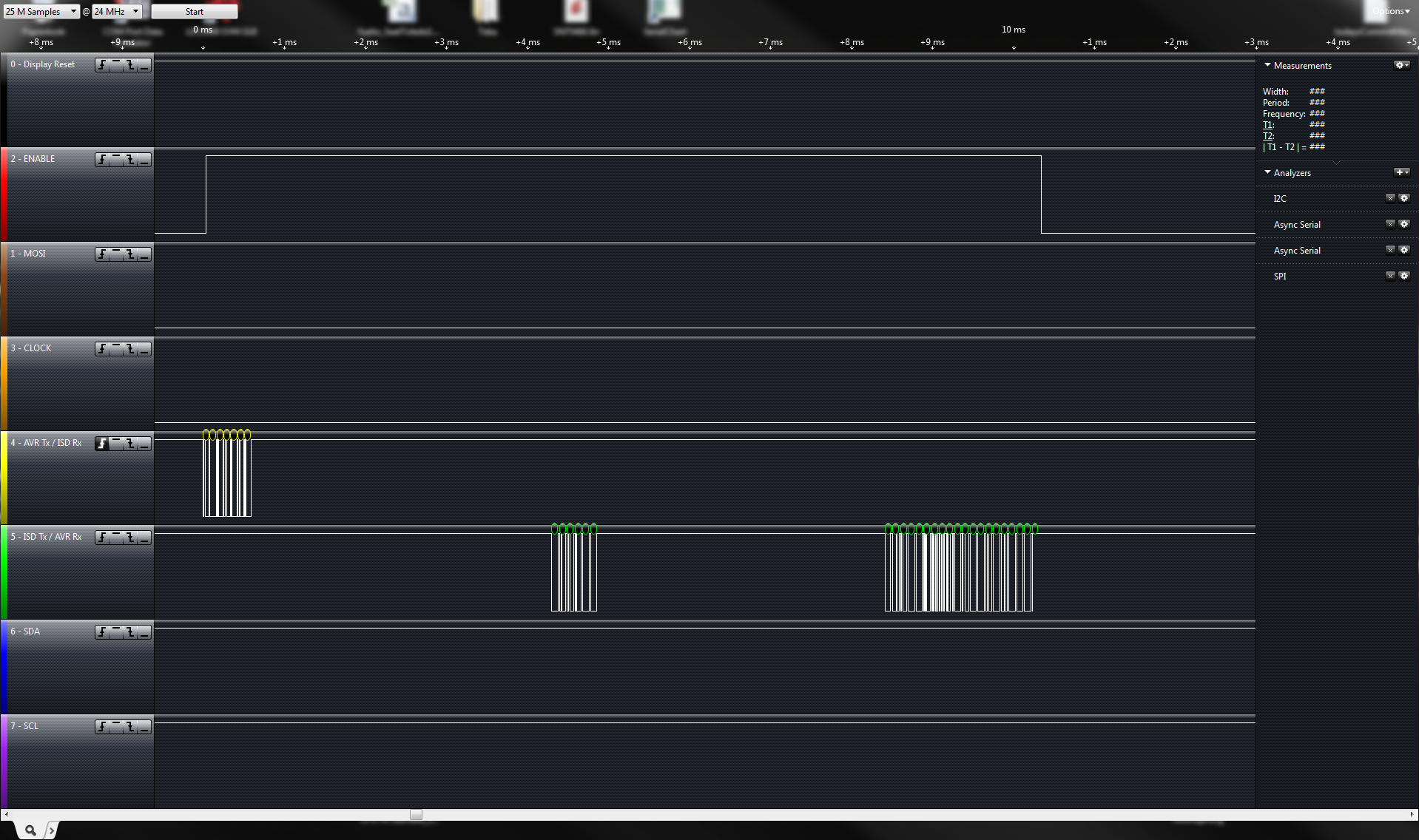

I noticed you have an empty loop in your main(), that loop uses up CPU cycles because main() is a thread with priority NORMALPRIO. Your thread is also at NORMALPRIO so it has to wait for the main() thread to finish its time slot (they are working in round-robin).
Put a chThdSleepMilliseconds(500) in your loop, this should be sufficient but normally is a good idea to have all threads at different priority levels.
goeck
Posts: 92
Joined: Mon Feb 11, 2013 12:00 pm
Re: UART latency
Post by goeck »
Giovanni,
seems like you've saved my day with this! :D
Actually such a stupid mistake, I must have removed this line by accident... :oops:
I now have a behaviour like expected. See screenshot again.

Screenshot
Screenshot
