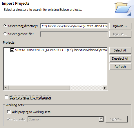

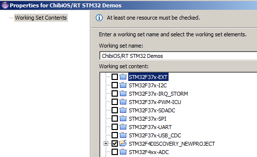

Hi everyone
I try to do the same, copy an existing project, change its name and reimport into ChibiStudio.
1. Copy/Paste the projectfolder on Windows (New Name STM32F4DISCOVERY_NEWPROJECT)
2. Change the Name of the project in the File .project under <name>STM32F4DISCOVERY_NEWPROJECT</name>
3. Import it in Eclipse under File/Import/Existing Projects into Workspace
4. Add it to a working set
5. Clean / Build works, but eclipse gives me an error.
Sometimes it works, sometimes not. Is there anywhere a wrong setting or path or something?
Thank for any help in advance!

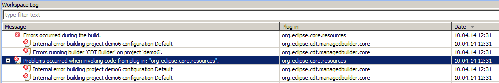

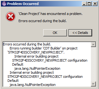

Same problem, very strange. I run it on W7/64, Java 32bit.
I'l try it on a WXP-Machine later.. But what can that be?

I tried it on a Windows XP (fresh installed). Same error.
I tried different demo-Projects. It is only the ARMCM4-STM32F407-DISCOVERY-Project making trouble..
I haven't tried every demo-project, but several are working fine copied the way you mentioned, including the MEMS-Demo.
Strange...
Strange...
