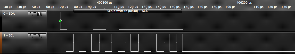

I get a complete I2C transaction (see first attachment for logic analyzer cap) when I call i2cMasterTransmitTimeout in the following manner (corresponding to a write of 'd' to register 'ra' on the IMU):
txbuf[0] = ra;
txbuf[1] = d;
status = i2cMasterTransmitTimeout(i2cptr, mpu9150_addr, txbuf, 2, rxbuf, 0, 100);
A complete write to the microcontroller, resetting the device

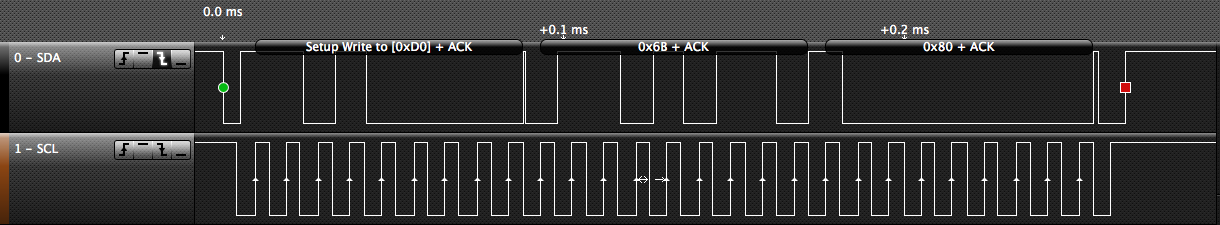

However, when I call it in the next manner (corresponding to a read from register 'ra', putting the data in 'd'), the microcontroller sends the address byte, receives an ack, and then hangs with SCL low until the timeout event (see second capture from logic analyzer):
txbuf[0] = ra;
status = i2cMasterTransmitTimeout(i2cptr, mpu9150_addr, txbuf, 1, rxbuf, 1, 100);
d = rxbuf[0];
An incomplete read from the microcontroller, hanging after transmitting device address
