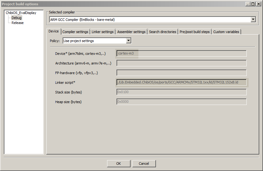

I have attached my project file that I was talking about early.
[img]How%20I%20can%20turn%20off/%20turn%20on%20hardware%20FPU%20support%20in%20EnBlock?%20I%20configured%20it%20with%20make%20file%20too%20earlier[/img]
I believe so. In the original project for F429 it was there. I just deleted this line.
Here is my project build option
Project build options.PNG (23.81 KiB) Viewed 10545 times
