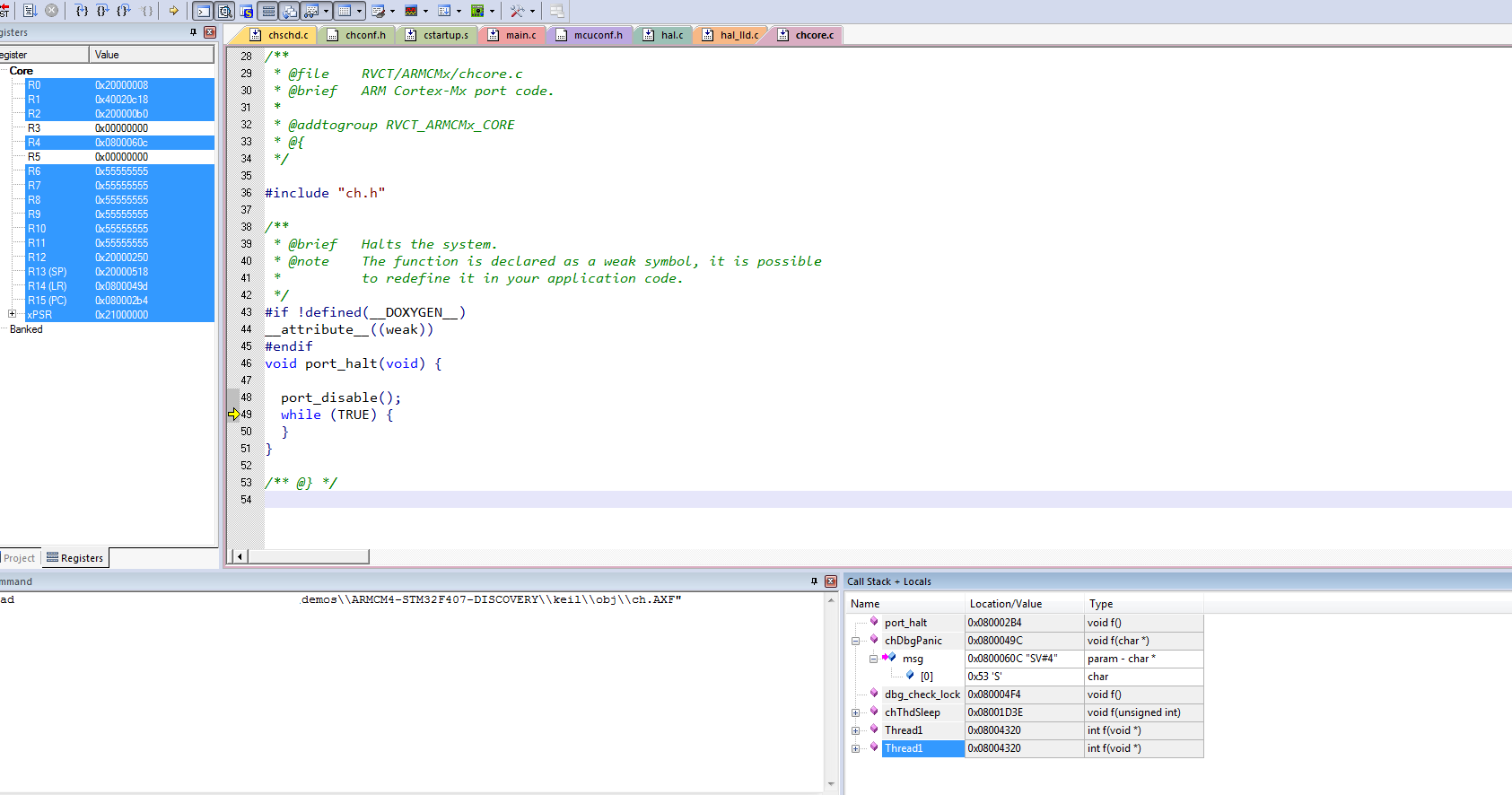

And here I again. The problem seems to be here, when both FPU(compiler and chconf.h) options are enabled. After some amount of time program stucks at the chthd.c
Tested on 2.6.8 discovery demo without optimization enabled, and with FPU enabled. Please, test it. Without FPU enabled all is working.
And here's screenshot with debug checking enabled.
do {
cp = cp->p_next;
} while (cp->p_prio >= tp->p_prio);
- debug.png (82.95 KiB) Viewed 3791 times
