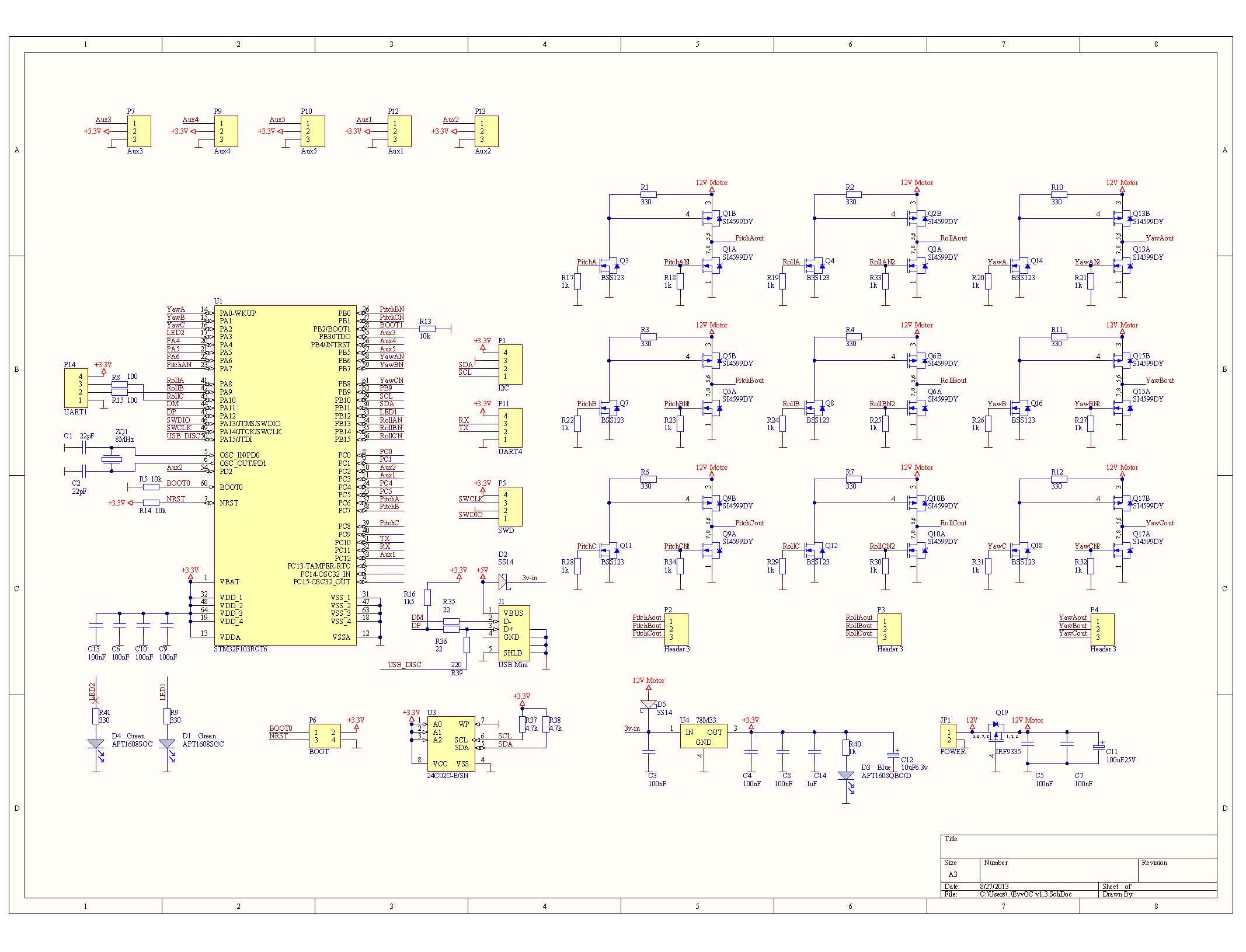

Are there some Guidance documents about modify code/config for specical board?
I am using board named Evvgc v1.3.
board schematic:
schematic
schematic
Re: The uart problem
You need to duplicate the board directory of a board that uses the same MCU then modify board.mk and board.h to fit your design. The documentation is inside board.h, basically you need to define clocks and setup of GPIOs, the meaning of the numbers you will see there are found in the GPIO section of the STM32 Reference Manual.
After creating your board files modify the Makefile to point to your new board.mk file.
