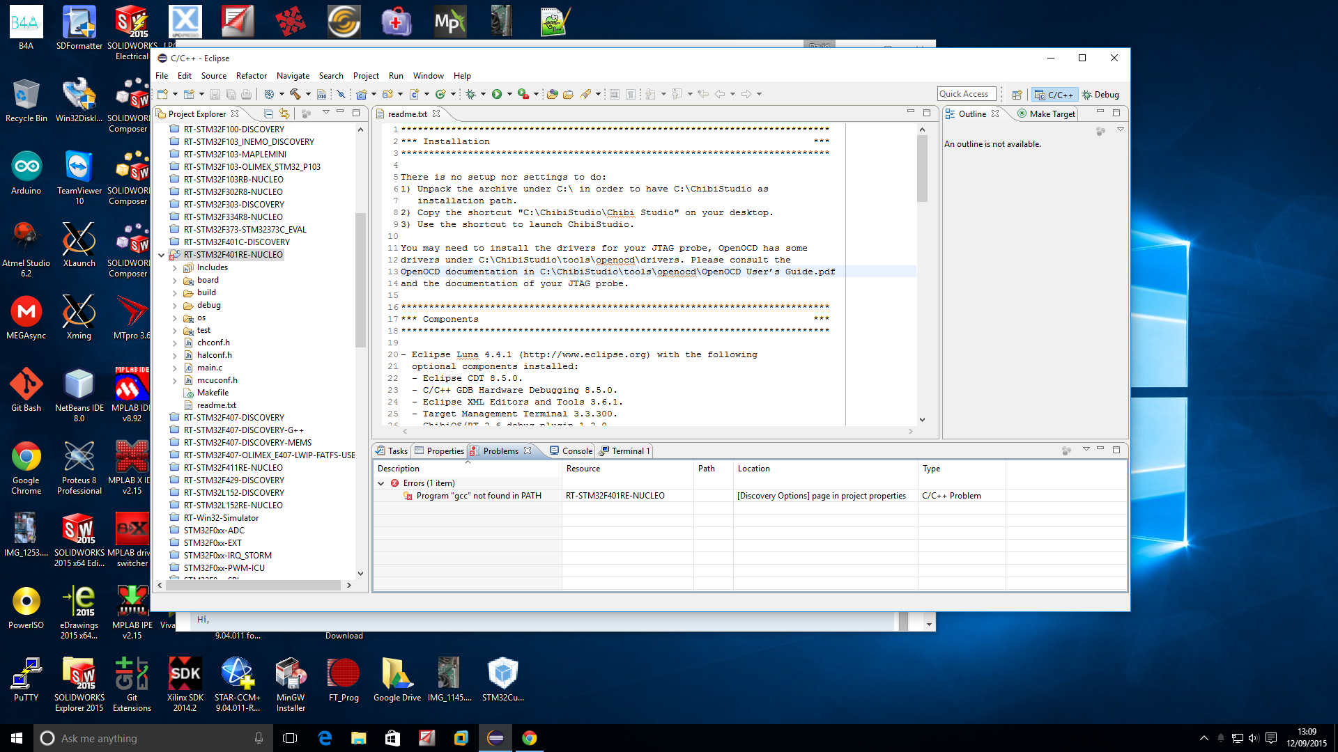

in the problems tab i get
Program "gcc" not found in path , and i find this with all demo projects in chilbistudio

attached screenshot showing error
