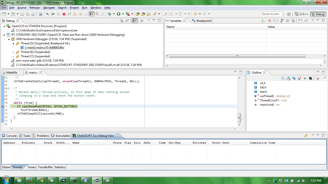

I'm having problems with the Chibi debug plugin with Preview16. Not seeing any information when I open the Eclipse debug plugin for 3.x.x.
I turned on all Debug options in chconf.h and compiled with -O0. I can step thru the code and use gdb normally but no ChibiOS debug info.

Try executing the code past chSysInit(), the threads list is not initialized before that so info cannot be retrieved.

I ran it well past chSysInit(). Still no Debug info with the ChibiOS plugin.

I see the same result when I run the unmodified demo RT-STM32F407-DISCOVERY with the F4 Discovery board (except for the chconf.h debugs and the Makefile -O0). I do see thread info from the "info threads" command but still nothing from the ChibiOS plugin.
With all the debugs turned on would a stack overflow not result in some sort of error message? Anything I else I could investigate?

You could verify if the Eclipse ChibiOS debug plugin (in ChibiStudio) is able to enumerate the threads.
If it is able then it is a problem in OpenOCD else there must be some memory corruption.

You need to refresh the view in order to see anything, see the button on the right.
