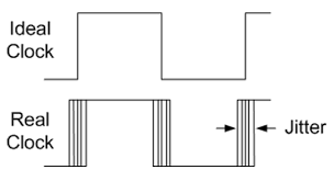

As said Giovanni, a jitter is a random time that you generally dont want. It appear on your signal.
For Example, if you want to toggle a gpio pin to have a square signal with a period of 100us. You wouldn't have 100us all the time you measure. You will for example have 101us, 99us, 103us and so on.
Here is an image to illustrate my explanation.

Here is a better illustration!
