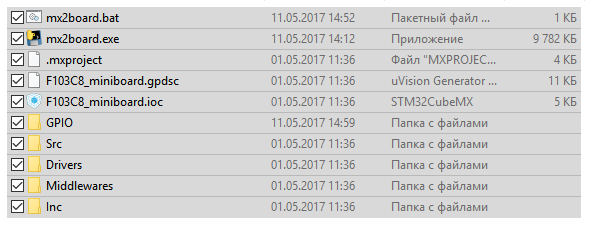

Sorry to disturb you, but I cant use your exe correct. Please, help me
I have made the *.bat file in the my CUBE project folder
mx2board -g GPIO
pause
But I have an error messages with the all options. What options and how should I use?

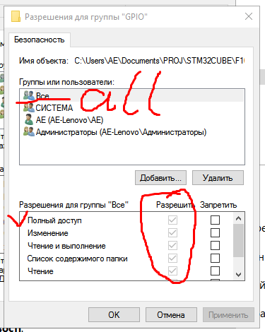

UPD
AAAAA!!! I have no permissions to the GPIO folder!
My problem has not solved I have no any idea :(
