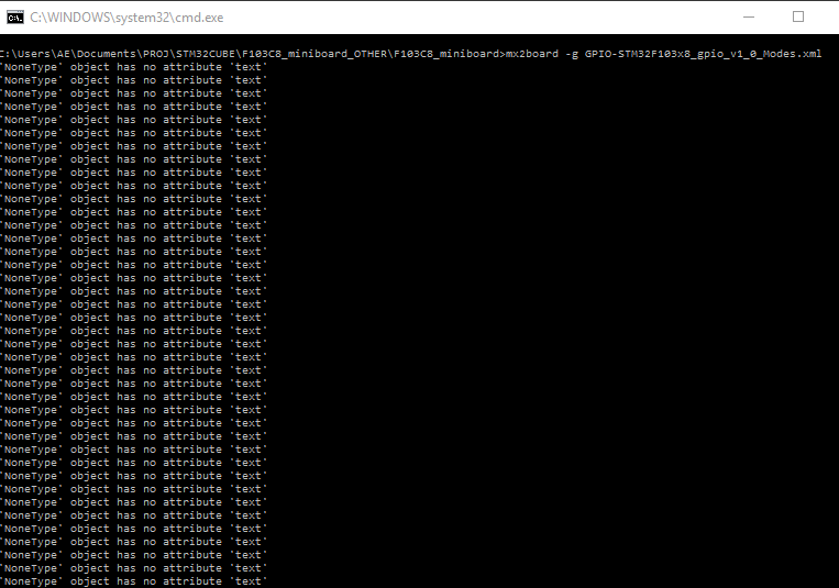

Hey,
you're doing it wrong ;)
-g is used to point to the GPIO file directly, not a folder. In your case it should be "GPIO-STM32F103x8_gpio_v1_0_Modes.xml" (find the file in cubemx folder and paste it in the same folder as the script)

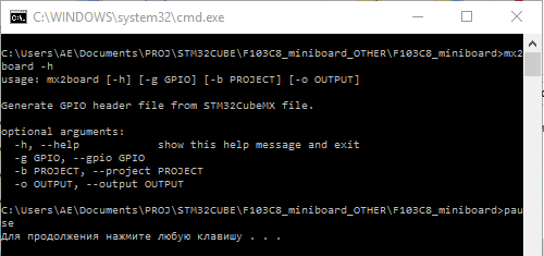

use -h to get information about the parameters.

Oops. We made one step and have stoped again. Excuse me. Could you give more wide instructions. For those stupid like me ... and I have no python, and don't know, how to use it :(

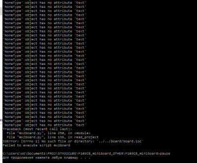

You did not specify your .ioc file... that's never going to work. (did you try -h as I advised?)
can you upload your .ioc file somewhere for me to test it?

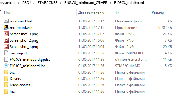

Yes! With plesure!
I want look at the example how to use your script. I don't understood what shall i do with it. I'm a beginner in MC programming.
F103C8_miniboard.zip
(1.58 KiB) Downloaded 805 times
And yes, I have tested the script with -h. But I still don't understand what should I use with it as the parameters... Please, give some examples with the comments

I just saw this is for an F1 device, which is not supported because they use the old GPIO IP.
Updated (v0.3) .exe here:
https://drive.google.com/open?id=0BzWyT ... TJXTzlYTEE
You can try with anything except F1xx devices.
