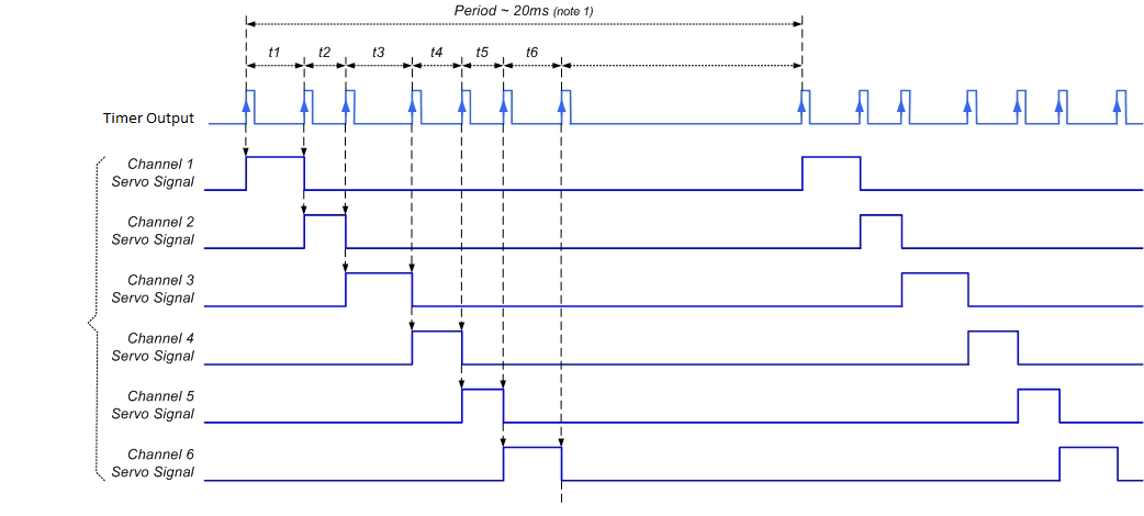

I am using decade counter to generate output for six servo. My question is can I use advance timers (timer 1 or 8) to load value of all the servo outputs into some registers so that they will automatically change without any software intervention.

Ok..Refer to figure attached. I want to generate output as shown by "Timer Output" (First Signal). Here it is generating pulses at predefined time interval t1,t2,t3,t4,t5,t6 at interval of 20 ms. My question is can I load values of t1 to t6 in some registers once every 20 ms so that it generates these pulses automatically?
PWM using decade counter.png (62.17 KiB) Viewed 7091 times
Re: PWM using decade counter
I think it is not possible to do that purely in hardware (I could be wrong), you may use the PWM driver to generate pulses changing the period on each falling edge (this way the change is effective in next cycle).

hi sapan,
Probably, trick can be done using DMA loading new value from memory each time counter finish to count.

Sapan, just one point: to drive the servos you don't need that the pulses arises one after the other. Each servo only have to know just its own channel.
At least with the STM32 I think that there are multiples ways to do it (I still haven't played with PWM, but judging from the datasheet it has plenty of features).

You are right. STM32 has plenty of PWM. I was just trying to optimize further so that using only one channel you can run more servo, that way you have rest of pins available for other functionality as well.

There is an example using DMA data to update TIM CCR from ST STM32F4 DSP lib. Maybe it could suit your requirement.
