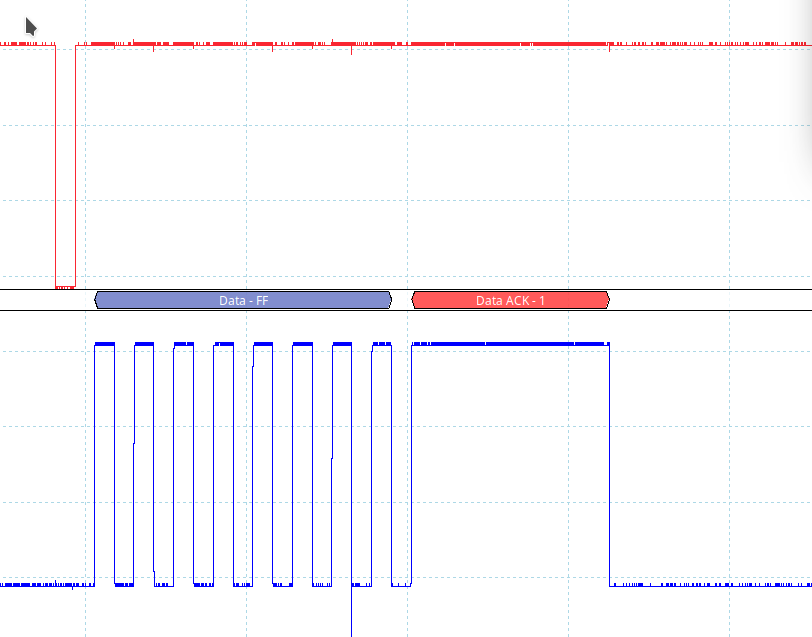

I2C driver stop working after first failed command. E.g.
    uint8_t addr = 0xFF << 1;
    i2cMasterReceiveTimeout(drv, addr, NULL, 0, TIME_S2I(2));
On oscilloscope i have next case. SCL is on low state and that's finish. No operations are allowed until restart of board.
I have added next fix and failed command doesn't brake I2C anymore.
diff --git a/os/hal/lib/fallback/I2C/hal_i2c_lld.c b/os/hal/lib/fallback/I2C/hal_i2c_lld.c
index e4ae9a9f9..37b3cb3ed 100644
--- a/os/hal/lib/fallback/I2C/hal_i2c_lld.c
+++ b/os/hal/lib/fallback/I2C/hal_i2c_lld.c
@@ -32,6 +32,8 @@
 #define CHECK_ERROR(msg)                                                    \
   if ((msg) < (msg_t)0) {                                                   \
+    palSetLine(i2cp->config->sda);                                          \^M
+    palSetLine(i2cp->config->scl);                                          \^M
     return MSG_TIMEOUT;                                                     \
Any other opinions about this case?

I use a wrapper API that creates a combined driver allowing mixed H/W and S/W I2C.
One of our team was experiencing this hang for a s/w driven device.
Thanks for the timely fix which saved me all sorts of debug time :-)
Bob
Re: I2C fallback doesn't work after first failure
Fixed as bug #1224.
