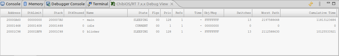

It is a normal thread, it is just created in a different way.
A quick test seems to agree with your finding, numbers are off, I will look into this.
