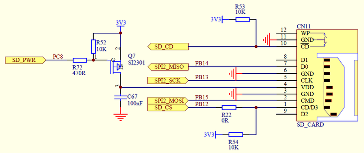

the enclosed folder contains the project modified to work with STM32F4Discovery. It works exactly like the ARMCM3-STM32F103ZG-FATFS demo with a few changes (serial tx is PA02 & serial rx is PA03). Obviously if I send "tree" command, this message is shown : "File System not mounted"...
In fact, my question is: How do I physically connect the SD-shield to the board?
I think that I've to use SPI3 (SPI1 & SPI2 is already used for accel. & mic.), isn't it?
in general for SD in SPI mode we have:
SD PIN_________SD FUNCTION_________F4Discovery_____pin
pin1___________CS__________________SPI3_NSS________PA15 ?
pin2___________DI__________________SPI3_MOSI_______PB5 ?
pin3___________GND________________GND
pin4___________VDD________________+3v3
pin5___________SCLK_______________SPI3_SCK________PB3 ?
pin7___________DO_________________SPI3_MISO_______PB4 ?
I think it's useful to many people, so what do you think about it?
Thank you all in advance!

Hello Fede,
Here's how an SD card socket is connected on one of my boards using SPI. There are no other pullup or pulldown resistors. The labels go directly to the pins of the MCU. The pins SD_CD and SD_CS are GPIOs. You have to give the information of the CS pin and port in your SPI config structure.
Also, you don't need the connections of pin 10 to 12 on the socket. These are only to check if a card has been inserted or if it's write protected.
Things to consider:
  • Make sure the PAL stuff is configured correctly (Output PushPull for the CS pin and alternative for the SPI pins)
  • In case of you don't have any pin where the socket tells you if a card has been inserted, make sure you wait a little bit after powerup because the card needs some initialisation time as well - or simply connect a switch you can manually use (I recommend this)
  • Make sure your SPI frequencies aren't too high. Lower them if all the poins from above didn't help at all
  • What SD card are you using? Newer SD cards have problems that they don't support the SPI interface properly anymore. For example, 8 out of 10 SD cards I have here didn't work that way, but all of them work with SDIO.
  • What toolchain are you using? Like many other ChibiOS people, I had some issues with mine. I highly recommend using this one. It even comes with precompiled binaries for Linux, Mac OSX and Windows.
I hope this helps somehow.

Many thanks Tectu, ok I will use the same SPI2 (PB12 PB13 PB14 PB15)... now hardware is setup, next step software!

Also, it dosen't matter which SPI you use as long as you configure it correctly. Also, I used an STM32F103 for that pic above, but that shouldn't matter at all.

No I don't have built the hardware yet! :) but I think (I hope) that your schematic will work fine!
Fede
Re: Simple DataLogger for STM32F4-Discovery
By the way, you don't need the transistor stuff as well. Just connect pin 4 of your SD card socket to +3.3V.
