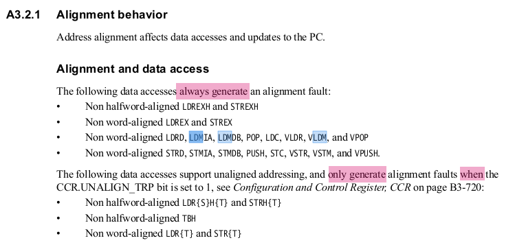

There is again LDR which works on any aligned/unaligned data in Cortex-M3/M4. But why? Let's see the docs:
So load/store multiple (which indeed a bit effective than LDR/STR when operating with many words at once) are ALWAYS generate unaligned fault regardless of an UNALIGN_TRP bit!!! So, assumption provided in the usb_lld.c is not always correct (as I thought from the start):
    /* Note, this line relies on the Cortex-M3/M4 ability to perform
       unaligned word accesses and on the LSB-first memory organization.*/
GCC always(?) generate LDR/STR. It is safe, but some times produce less effective code then RVCT. We can't be sure that in the future versions of GCC (or any other compiler) it not became more effective and starts to use LDM (or any other cmd) with alignment restrictions described above. Do you agree that we can't rely on that? Instead of that it is needed to provide compiler with explicit info that this part of code it should compile as we expect from it. As a result, it is mandatory to use a "packed" qualifier on such data pointers. Example is in my previous post.
