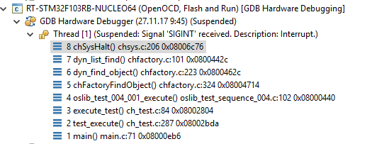

Test suite hangs in chfactory.c line 101 chDbgAssert(false, "invalid reference passed");, see image.

test suite running OK after last fix in trunk :)
