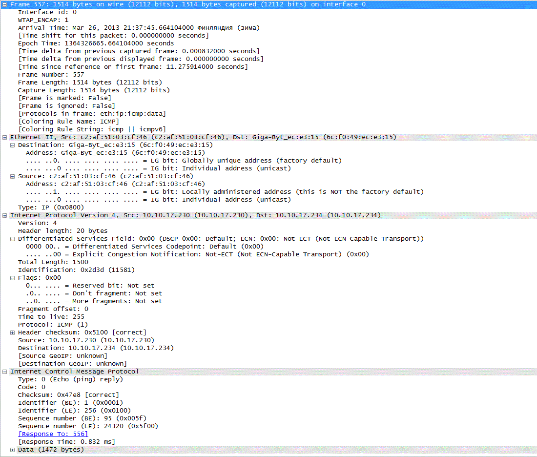

Giovanni wrote:The frame size is set to 1522 which is the maximum. Probably it is because the IPv4 header is up to 20 bytes long.
Frame length is 1514 max. Look for this packet:
Re: [TODO] Starting ChibiOS on STM32F107 with Keil
I mean, it is set to 1522 in the driver.
#define STM32_MAC_BUFFERS_SIZE 1522

It seems Ethernet MTU is 1500 max. in my system.
