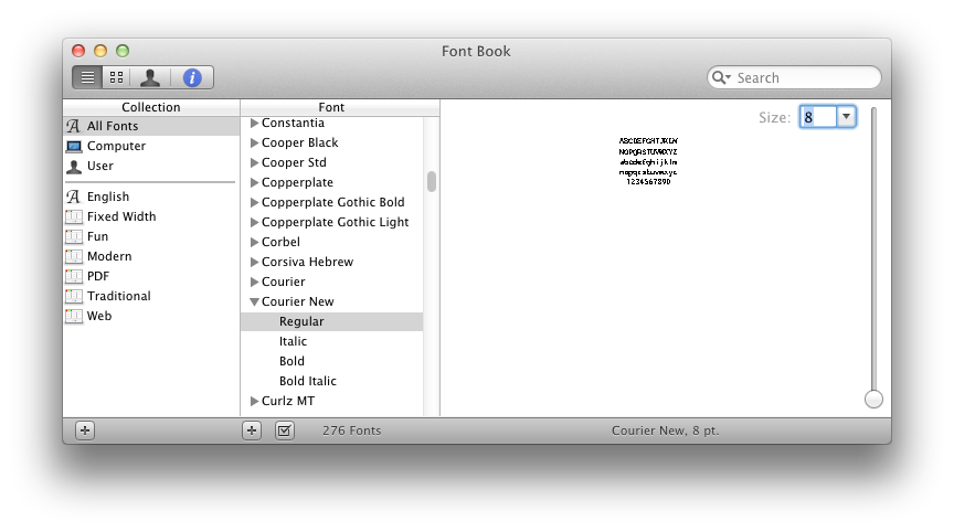

Is font size configurable for Eclipse plugins? on Mac OS X with Eclipse Helios the font size of the Chibios plugin is incredibly small - very pixelated and basically impossible to read. The actual window elements are fine, but the information about the threads etc is super small. This is with v 1.0.7 - I haven't tried any other versions.

The font is a Courier-new 8, it this font present in Mac OS?

It is present but looks really small, even in the font util.
That is exactly how it appears in the chibios plugin as well. Most of the other fonts look better at size 8.
Hmm attachment doesnt seem to work very well. see here http://imageshack.us/photo/my-images/37 ... at174.png/
Courier-new size 8
Courier-new size 8
Screen Shot 2011-09-12 at 17.47.44.png (78.91 KiB) Viewed 7789 times

Strange, it does not look that way in both Windows and Linux, I will look into adding a font option but that would create a lot of other problems with column sizes.

For reference, 'Courier' looks fine at size 8. Are you able to detect which OS is being used and switch accordingly?
