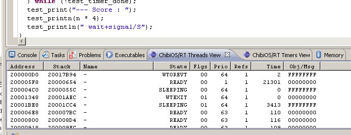

A prototype is available here: http://www.chibios.org/plugins/org.chib ... _1.0.0.jar
It allows to explore the threads list and the timers list, so far I tested it with Eclipse Helios and Indigo.
Few notes:
  • Put the plug-in into the plug-ins directory of your Eclipse installation.
  • Enable the plug-in while in the "Debug" view under: Window->Show View->Other...->ChibiOS/RT->ChibiOS/RT
  • The plug-in uses the "Standard" Eclipse debugger, not the "DSF" one, you may select the debugger associated to the "GDB Hardware Debugging" under Window->Preferences->Run/Debug->Launching->Default Launchers.
  • I haven't tested the plug-in with the Zylin plug-in because Indigo no more supports it, could somebody report if it works?
The plug-in has 3 sub-views:
  • General, not currently filled, it will show global info about the kernel state.
  • Threads, the list of threads, it also shows thread names using the latest kernel in the trunk.
  • Timers, the list of enabled virtual timers.
In order to update a view press the refresh button (the yellow one) in the plug-in tool bar. The kernel must have already be initialized or the plug-in will report an error when it tries to read the system lists.
Note that the views are refreshable only when the target is suspended (because a breakpoint or the suspend button), while it is running the memory is not accessible and the refresh button has no effect.

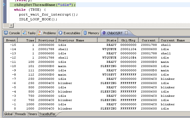

New preview: http://www.chibios.org/plugins/org.chib ... _1.0.1.jar
This one is able to inspect the Trace Buffer too:
Note that this feature requires the kernel currently in the repository.
