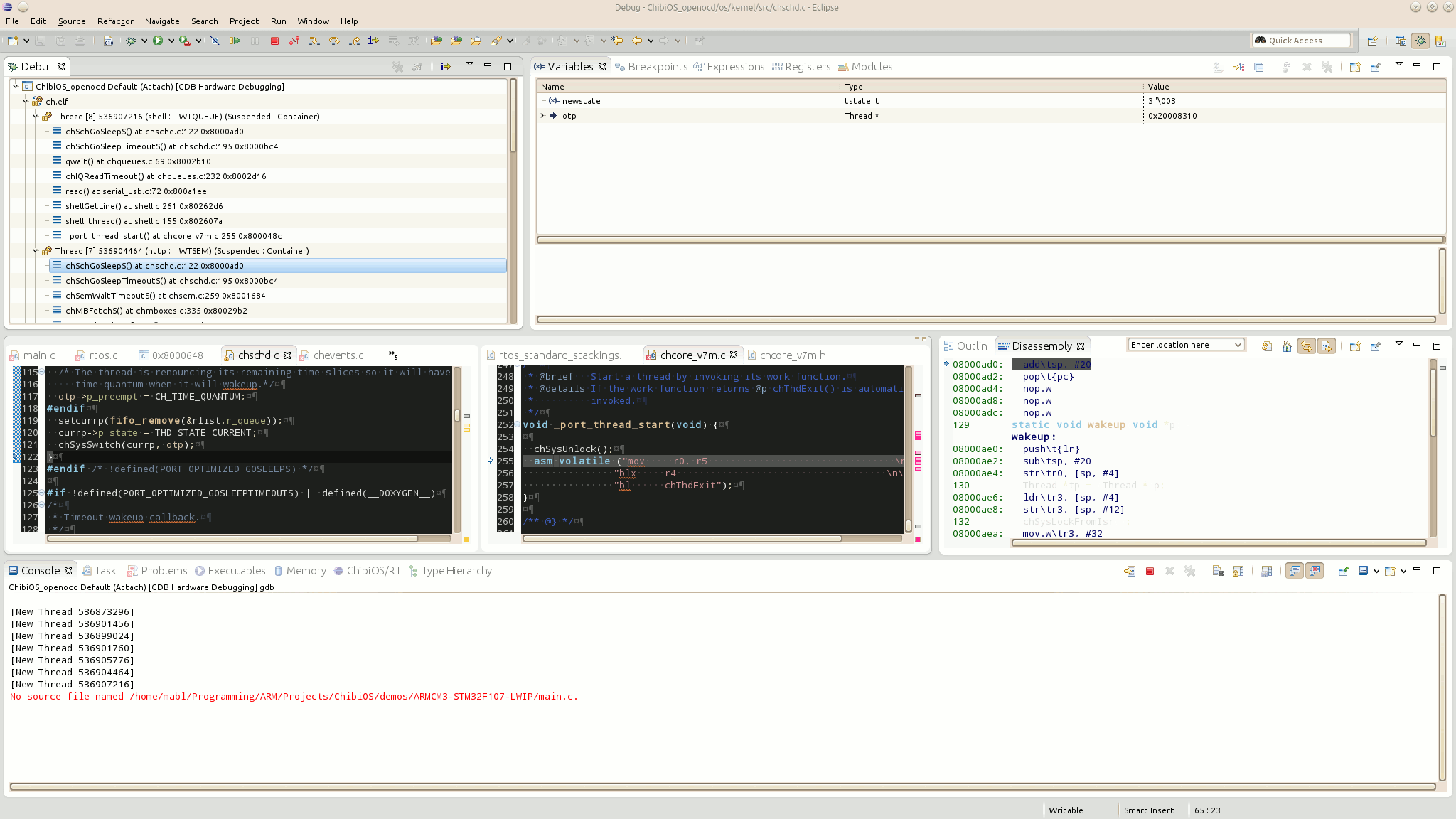

Yeaha Thinks look brighter now. I think it was an alignment issue....
(gdb) thread apply all bt
[New Thread 536899336]
[New Thread 536901456]
[New Thread 536899024]
[New Thread 536901760]
[New Thread 536905776]
[New Thread 536904464]
[New Thread 536907216]
Thread 8 (Thread 536907216):
#0 chSchGoSleepS (newstate=13 '\r') at ../../os/kernel/src/chschd.c:122
#1 0x08000bc4 in chSchGoSleepTimeoutS (newstate=13 '\r', time=4294967295) at ../../os/kernel/src/chschd.c:195
#2 0x08002b10 in qwait (qp=0x20006b54, time=4294967295) at ../../os/kernel/src/chqueues.c:69
#3 0x08002d16 in chIQReadTimeout (iqp=0x20006b54, bp=0x200095eb "\b\034\226", n=1, time=4294967295) at ../../os/kernel/src/chqueues.c:232
#4 0x0800a1ee in read (ip=0x20006b48, bp=0x200095eb "\b\034\226", n=1) at ../../os/hal/src/serial_usb.c:72
#5 0x080262d6 in shellGetLine (chp=0x20006b48, line=0x2000961c "x\360~x\360~P", size=64) at ../../os/various/shell.c:261
#6 0x0802607a in shell_thread (p=0x8028a08) at ../../os/various/shell.c:155
#7 0x0800048c in _port_thread_start () at ../../os/ports/GCC/ARMCMx/chcore_v7m.c:255
Backtrace stopped: frame did not save the PC
Thread 7 (Thread 536904464):
#0 chSchGoSleepS (newstate=3 '\003') at ../../os/kernel/src/chschd.c:122
#1 0x08000bc4 in chSchGoSleepTimeoutS (newstate=3 '\003', time=4294967295) at ../../os/kernel/src/chschd.c:195
#2 0x08001684 in chSemWaitTimeoutS (sp=0x20008d10, time=4294967295) at ../../os/kernel/src/chsem.c:259
#3 0x080029b2 in chMBFetchS (mbp=0x20008d00, msgp=0x20008790, time=4294967295) at ../../os/kernel/src/chmboxes.c:335
#4 0x0801004c in sys_arch_mbox_fetch (mbox=0x20003b7c, msg=0x20008790, timeout=0) at ../../os/various/lwip_bindings/arch/sys_arch.c:169
#5 0x0801c3d8 in netconn_accept (conn=0x20003b68, new_conn=0x200087ac) at ../../ext/lwip/src/api/api_lib.c:304
#6 0x080264da in http_server (p=0x0) at web/web.c:115
Thread 6 (Thread 536905776):
#1 0x08000baa in chSchGoSleepTimeoutS (newstate=3 '\003', time=1000) at ../../os/kernel/src/chschd.c:190
#2 0x08001684 in chSemWaitTimeoutS (sp=0x20008808, time=1000) at ../../os/kernel/src/chsem.c:259
#3 0x080029b2 in chMBFetchS (mbp=0x200087f8, msgp=0x20008cd4, time=1000) at ../../os/kernel/src/chmboxes.c:335
#4 0x0801004c in sys_arch_mbox_fetch (mbox=0x200064d4, msg=0x20008cd4, timeout=1000) at ../../os/various/lwip_bindings/arch/sys_arch.c:169
#5 0x0801bf80 in sys_timeouts_mbox_fetch (mbox=0x200064d4, msg=0x20008cd4) at ../../ext/lwip/src/core/timers.c:430
#6 0x080205ec in tcpip_thread (arg=0x0) at ../../ext/lwip/src/api/tcpip.c:88
Thread 5 (Thread 536901760):
#0 chSchGoSleepS (newstate=8 '\b') at ../../os/kernel/src/chschd.c:122
#1 0x080022e8 in chEvtWaitAny (mask=4294967295) at ../../os/kernel/src/chevents.c:380
#2 0x0800fbd4 in lwip_thread (p=0x0) at ../../os/various/lwip_bindings/lwipthread.c:275
#3 0x0800048c in _port_thread_start () at ../../os/ports/GCC/ARMCMx/chcore_v7m.c:255
Thread 4 (Thread 536899024):
#0 chSchGoSleepS (newstate=6 '\006') at ../../os/kernel/src/chschd.c:122
#1 0x08000baa in chSchGoSleepTimeoutS (newstate=6 '\006', time=125) at ../../os/kernel/src/chschd.c:190
#2 0x08001018 in chThdSleep (time=125) at ../../os/kernel/src/chthreads.c:290
#3 0x08026b30 in Thread1 (arg=0x0) at main.c:595
#4 0x0800048c in _port_thread_start () at ../../os/ports/GCC/ARMCMx/chcore_v7m.c:255
Thread 3 (Thread 536901456):
#0 chSchGoSleepS (newstate=2 '\002') at ../../os/kernel/src/chschd.c:122
#1 0x0800ecca in usb_lld_pump (p=0x200076f8) at ../../os/hal/platforms/STM32/OTGv1/usb_lld.c:694
#2 0x0800048c in _port_thread_start () at ../../os/ports/GCC/ARMCMx/chcore_v7m.c:255
Thread 2 (Thread 536899336):
#0 _idle_thread (p=0x0) at ../../os/kernel/src/chsys.c:61
#1 0x0800048c in _port_thread_start () at ../../os/ports/GCC/ARMCMx/chcore_v7m.c:255
Thread 1 (Thread 536873296):
#1 0x08000baa in chSchGoSleepTimeoutS (newstate=8 '\b', time=500) at ../../os/kernel/src/chschd.c:190
#2 0x080023d0 in chEvtWaitOneTimeout (mask=4294967295, time=500) at ../../os/kernel/src/chevents.c:451
#3 0x08026d12 in main () at main.c:685
