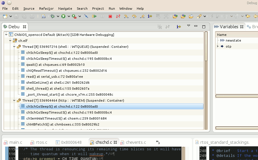

The first prototype is working and eclipse is showing all threads currently running on the target:
Note, that openocd rtos support does currently not support the hardware FPU. You can disable it in your makefile.

Hello all,
since Giovanni gently pointed me to openocd for true thread support I tried to implement it last night.
What's already working is the detection of all treads. So if I go into gdb and issue a "info threads" I get a list with all threads and their names:
