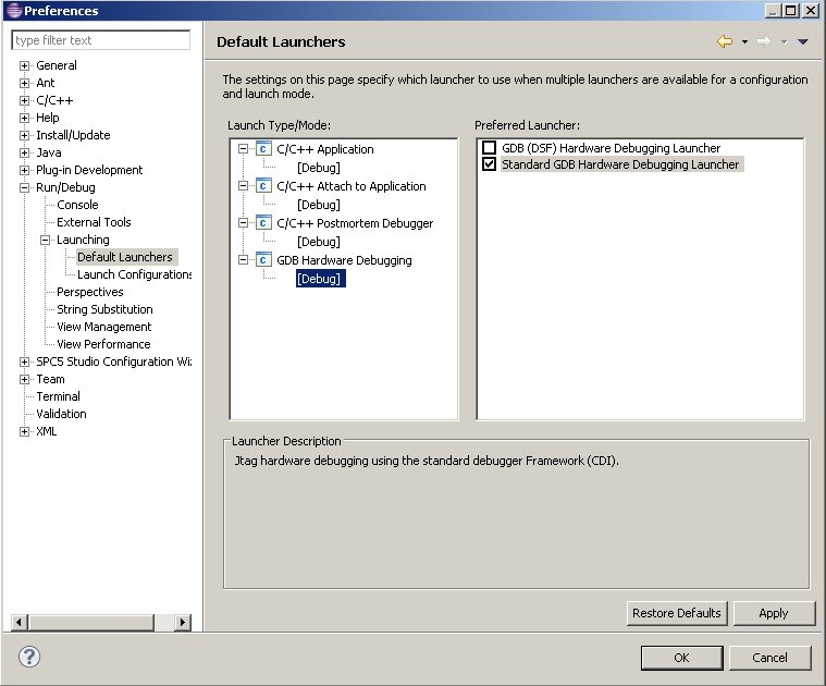

I am running Eclipse with ChibiOS plugin in Ubuntu 12.04 and althoug I can debug the program with the GDB plugin, I can't see the thread info in ChibiOS/RT tab (see the attached image, you have to scroll down as it is on the bottom of the screen).
Is there a way how to turn on the ChibiOS/RT tab? Obviously I can see the variables individually (trace buffer etc.) but I can't make them show in the neat table.
I have all the debug checks in chconf.h enabled. I am using Eclipse Kepler Service Release 1 (build id 20130919-0819) with GDB debugger version 7.2.0 and ChibiOS v 2.6.2 and arm-none-eabi toolchain version 4.7.4 20130913, ChibiOS Configuration support plugin 1.3.0 and ChibiOS Debug Support plugin 1.1.0 (these plugins were copied from ChibiStudio).
Also, is there a zip file with ChibiStudio for linux? On sourceforge is only windows version (http://sourceforge.net/projects/chibios ... ibiStudio/)
Thanks.
Michal

by Giovanni
Threads become visible after executing chSysInit(), structures are not initialized before that point. You also need to click the "refresh" button in the plugin (the small two yellow arrows), it is not done automatically.

i tried as you suggested - probably I should have posted a printscreen from the actual debugging:)
As you can see, when I stopped the program, there should have been 4 threads already plus the main thread.
Even after refresh, there is nothing in the ChibiOS/RT - threads tab.
All the sub tabs (timers, trace buffer...) are empty as well, but in the upper right corner you can see that the trace buffer definitely exists and has data, it is just not shown in the bottom tab.
Any ideas?
M

by Giovanni
Are you using the standard debug mode in Eclipse? the debug plugin does not support the "DSF" debugger which is default of late.
