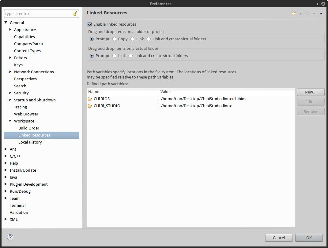

I've imported it but most of the paths are absolute, is it due to eclipse or is it possible to setup paths relative to the workspace?
Re: ChibiStudio for linux
Project paths should be all relative to two variables CHIBIOS and CHIBISTUDIO that are defaulted to C:\ChibiStudio and C:\ChibiStudio\chibios. There should not be absolute paths, only those variables need to be changed.

I've updated those two variables in windows->preferencies->general->workspace->linked resources, but projects still point to c:\ChibiStudio, i'm attaching two screenshot.
Not sure I'm modifying the correct stuff...

If I look for "C:\ChibiStudio" in the workspace i get 266 references:
tino@Dell:~/Desktop/ChibiStudio-linux/workspace$ grep -rn "C:/ChibiStudio" .metadata/.plugins/* | wc -l
266
I really don't know how eclipse manages environment variables and paths, it looks weird

I've tried to find&replace every occurrence of C:/ChibiStudio with ${CHIBI_STUDIO}, the problem is that it seems the project location path is in a binary file:
Binary file .metadata/.plugins/org.eclipse.core.resources/.projects/ARMCM4-STM32F407-DISCOVERY/.location matches
so I'm still not able to open the demo projects. If I modify that entry by hand eclipse wont start at all.
BTW, I can import again all the projects and it will work, but if you move the workspace you have to do it again. And we would have different workspaces for windows and linux, not easy to mantain..
