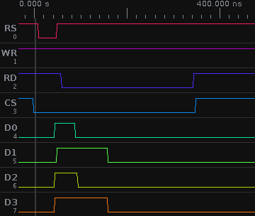

I'm trying to get FSMC working on my F4 discovery with S6D1121. the attached file shows the result of writing 0x000A (1010 on lower 4 bits) to the FSMC ports. For some reason all pins are initially high then transition to their intended state. I'm not sure if this is the problem, but it seems strange.. In this image I am driving the RD/CS/WR/RS pins using GPIO. I get the same problem when the FSMC hardware controls those pins.
edit: now that I think about it, the FSMC peripheral probably sets all pins to high before setting any to low. If I use the FSMC RD/CS/.. signals they all transition as the data pins go to the correct state.

I got it working! at least I can read 0x1121 from register 0x000.
the connections were a bit loose. apparently this isn't an ideal way to wire it up:
