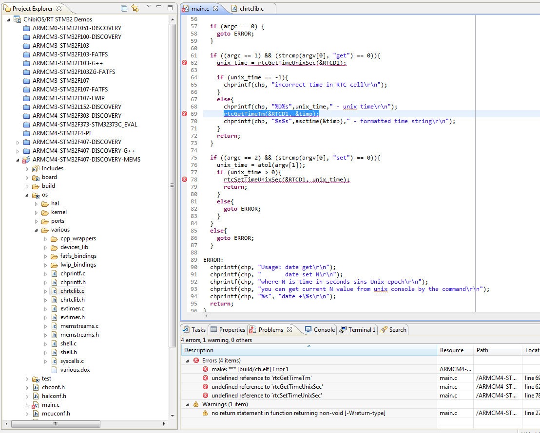

Ok I try to add code to a actual sample.
In code chrtclib.c is needed so I add "#include "chrtclib.h"" to main.c
I get compile error (see picture)
Re: Problem compiling project
You need to enable the RTC driver in halconf.h.

I think I did?
* @brief Enables the RTC subsystem.
#if !defined(HAL_USE_RTC) || defined(__DOXYGEN__)
#define HAL_USE_RTC TRUE

Have you included chrtclib.c in your Makefile?
CSRC += $(CHIBIOS)/os/various/chrtclib.c
Post by Joerg-SH »
Thats was it, thanks a lot.
