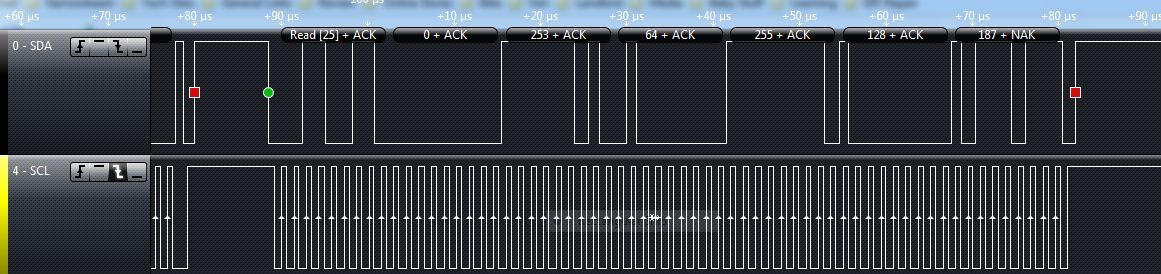

Issue - I2C Bus - protocol analyser not matching array content after i2cMasterTransmitTimeout/i2cMasterReceiveTimeout
Solution - Turn up sample rate on analyser :-(
... I was accidentally using 16Mhz on the analyser and seeing differences. Just as I wrote that fact, I thought I would up to 24Mhz and my data corruption went away. Given I didn't know the bus rate as I've included the magic 0x00902025 config value I didn't think

The sample below shows:
Analyser: 0 - 253 - 64 - 255 - 128 - 187
chPrintf : 64 - 253 - 0 - 255 - 0 - 188
Note that the other analyser traffic for the initial config statements is correct and both match every time with a 20ms delay set.
Alanyser is sampling at 16Mhz

Sample Analyser Capture:
Analyser Sample
Analyser Sample
