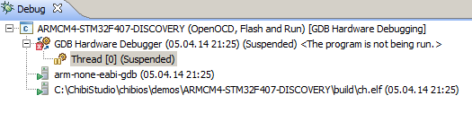

Hi there, I've got the same issue here.
OS: Tested with Win7/64 and WXP SP3
1. Installed fresh ChibiStudio with i586 Java. Apart from that, nothing else. No drivers for the discovery, nothing.
2. Project Explorer, Project ARMCM4-STM32F407-DISCOVERY open
3. Run/Debug History/ARMCM4-STM32F407-DISCOVERY (OpenOCD, Flash and Run)
Results:
Execution is suspended because of Error
symbol-file C:\\ChibiStudio\\chibios\\demos\\ARMCM4-STM32F407-DISCOVERY\\build\\ch.elf
set remotetimeout 20
monitor reset init
"monitor" command not supported by this target.
monitor sleep 50
load C:\\ChibiStudio\\chibios\\demos\\ARMCM4-STM32F407-DISCOVERY\\build\\ch.elf
You can't do that when your target is `None'
tbreak main
Cannot access memory at address 0x8000192
continue
The program is not being run.
On the board sits a STM32F407VGT6.
Do I miss something basic?
The jumpers on the ST-Link are in place. Do I have to connect something more?
Do I have to set breakpoints?
Do I need drivers for the ST-Link?
Thanks for any help or guidance beforehand!
Re: Open OCD with stm32F4dicovery
You need to launch OpenOCD before starding "flash and run", there is a link "OpenOCD on STLink v2" in the tools menu in the toolbar.
See the attached presentation.
