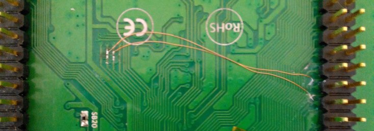

In order to be able to use SDIO interface and also I2S3 on a F4 Discovery board, I cut the traces going to the CS43L22 from PC10 and PC12 and connected them to PB3 and PB5 respectively, and appropriately remapped the GPIOs.
However I found that I am unable to send data on the I2S3 and simulatenously read another chunk of data from the SD card to enable continuous playback, it fails with a CRC Check Fail error on the sdcRead. After every I2S transfer I have to wait for TX to complete and then receive data from the SD Card before beginning another transmission.

I am unable to troubleshoot further, but suspect a hardware issue.
I attach the screenshot of the modded F4 board
The left trace cut was PC12 (SDIO_CK) and now connected to PB5 (Alt. I2S3_SD)
The right trace cut was PC10 (SDIO_D2) and now connected to PB3(Alt. I2S3_CK)
hacked F4D.jpg (44.41 KiB) Viewed 8184 times

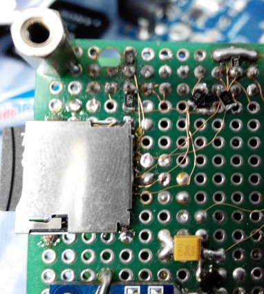

My hardware is built wire-wrap. The wires are not quite long from the pinheaders connecting the Discovery board to the microSD connector.
I have 47K pull-ups on all pins except SDIO_CK.
Now I have put 100E resistors in series with SDIO_D2 and SDIO_CK.
The 0.1uF decoupling cap, 10uF capacitor are connected to the power rail via a "via" (4 filled holes in the middle of the SD Card socket) - which I now realise was a bad idea as the via inductance is "killing" the decoupling capacitor. Power to the SD Card is controlled by a PMOS transistor on the bottom layer.
Here is a screenshot. Not quite neat, but it is hopefully working OK now.
What problems could I face in the future? Should I add another 0.1uF decoupling cap near the SD power pins?
Regards
Abhishek
pito
Posts: 199
Joined: Sun Nov 06, 2011 3:54 pm
Re: SDIO Conflict with I2S on modded F4 Discovery Board
Post by pito »
An sdcard can take 100mA peak. So I would use thicker wires for its power and ground. Also I always use few ceramic multilayer 10u smd capacitors (2-3) for its decoupling, instead of an aluminum or tantalum types. Place the decoupling capacitors close at sdcard's vcc pins (when using transistor for switching the power always place the capacitors at sdcard's side).
