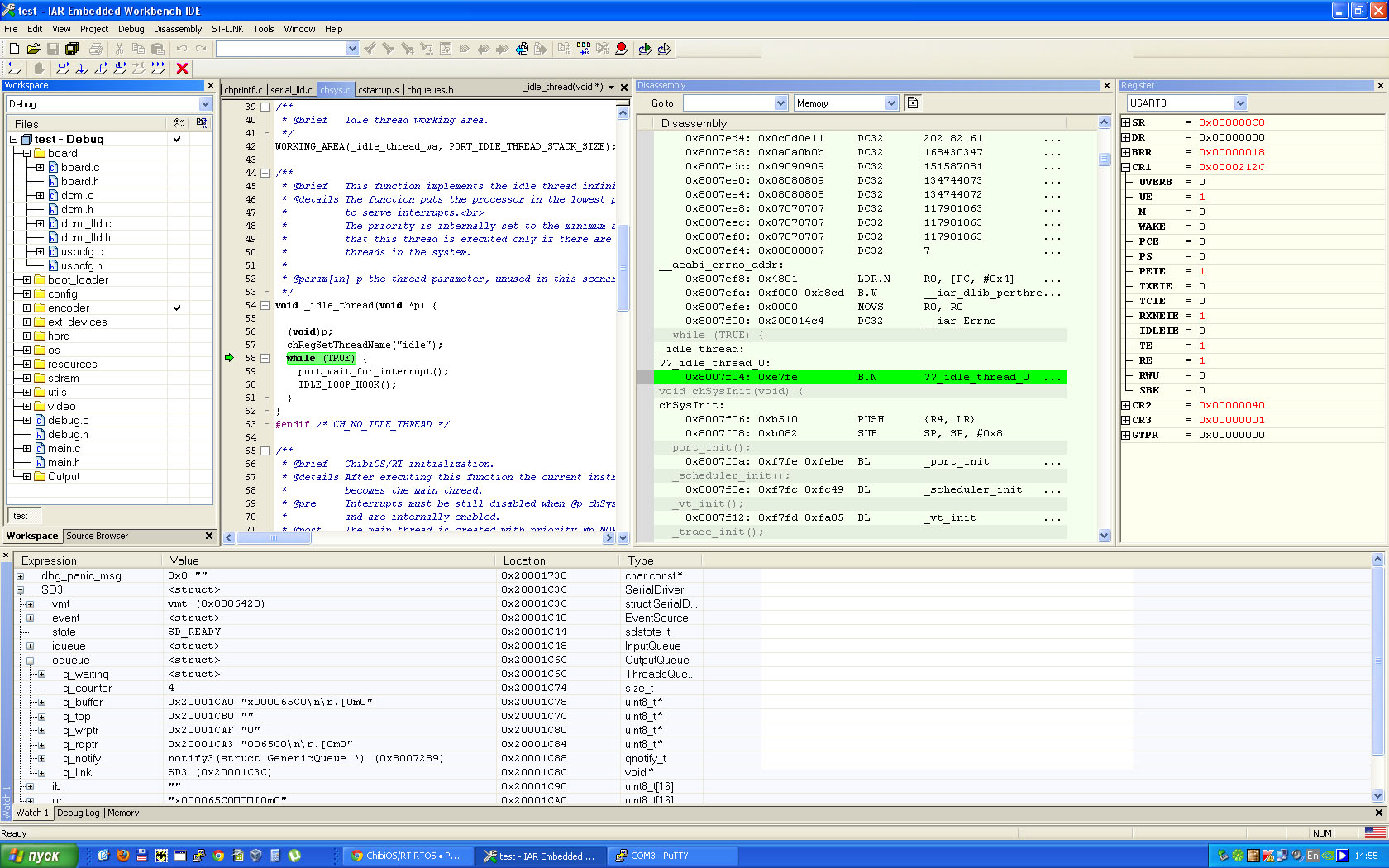

It seems I found the problem in serial_lld file. It is race condition in serve_interrupt routine.
I can't make simple test application to reproduce error but in my application I can show it.

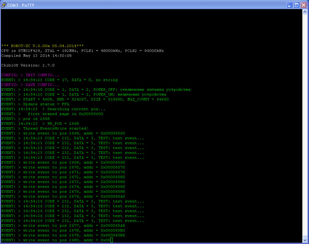

In this test I periodically writing some text with chprintf to SD3 at high baud rate: 2Mbit (I allways using such speed to print debug info to PC termial, I used putty). After some portion of text I make pause 3 sec. Theoretically all data in SerialDriver output buffer must be sended to PC, but in some cases it is not. See the picture 'test_serial1.jpg'. In this picture You can see that SD3 out queue not empty but TXEIE bit of CR1 of USART3 is clear that means no Interrupt will be generated and no characters will be sended. I check the serve_interrupt routine and I think it has error. After my modifications the driver works without "frozen" buffers. Also You change USARTx.CR1 register without locks and use it "cached" copy in 'cr1' later but function 'Notify' also change this register in Thread context.

Re: chprintf buffer partially sent over rs232
Thanks, I see the race condition.
What happens is: the TC interrupt is triggered but the queue is filled again, the TC handler disables both TXE and TC so the queue remains filled and transmission is not restarted until the next write to the queue (which could not happen, this is your stalled condition I think).
I don't know if your fix is sufficient, probably, if the queue is again full, the TC event should not be generated at all because data is still being transmitted.
Could you try this?

Yes, it works with this code.
  /* Physical transmission end.*/
  if (sr & USART_SR_TC) {
    chSysLockFromIsr();
    if (chOQIsEmptyI(&sdp->oqueue))
      chnAddFlagsI(sdp, CHN_TRANSMISSION_END);
    u->CR1 = cr1 & ~USART_CR1_TCIE;
    u->SR = ~USART_SR_TC;
    chSysUnlockFromIsr();
Looks like the problem is solved.
