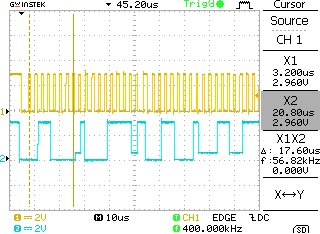

Ive got something working but not very happy abou the apparent bus contention, see attached file

Hi Giovanni, the issue was not setting SDA line to Open Drain. I was kind of assuming this was set correctly when you select AF mode 4, but this is not the case.
Cheers :-)
