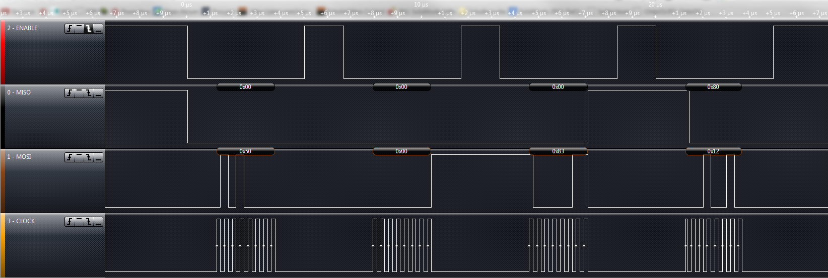

I need a hint on the SPI peripheral optimization. I am using a L6470 dSPIN device at the SPI bus attached to a STM32F0Discovery, which pretty much works. If I look at the lines, I see ugly stuff though and I want to get rid of that, maybe one has some advices for me. Please have a look at the following screenshot showing a 4byte long communication with a selected L6470. I see some quirks:
    - MOSI line flips around in between transmission of single bytes (looks the same on a scope)
    - time between transmission of each byte takes very long
    - timespan from sending byte done until ENABLE goes high is very long
The L6470 has to be supplied with a ENABLE line double toggle after each byte is sent out, the high timespan has to be at least 800ns. If I do a spiExchange of N=4 bits this works yust like expected, but the L6470 just doesn't understand this. Basically I thought of just interrupting the quick transfer of bytes only by 1-2us. It turns out, I can't narrow the timegap closer than 28us :-(

Saleae Logic analyzer screenshot

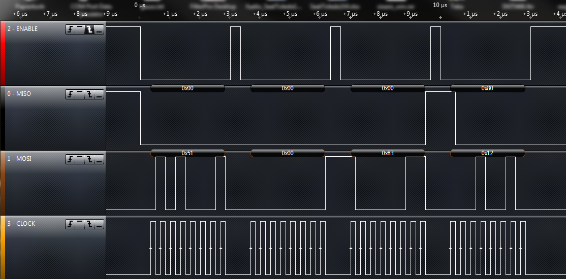

I just figured out, I could use polled exchange (for testing purposes at least), since it's implemented in the LLD.
See what I've got with that portion of code:
uint8_t dSPIN_Write_Byte(uint8_t byte)
   static uint8_t spiBufferTx[1] = { 0 };
   static uint8_t spiBufferRx[1] = { 0 };
   spiBufferTx[0] = byte;
   dSPIN_Acquire_Bus();
//   spiExchange(&SPID1, 1, spiBufferTx, spiBufferRx);
   spiBufferRx[0] = spi_lld_polled_exchange(&SPID1, byte);
   dSPIN_Release_Bus();
   return spiBufferRx[0];
Whole transmission takes 25us.
Conclusion would be, exactly the comment of spi_lld_polled_exchange(): laying calling thread asleep and awaking it after spiExchange has finished is too expensive when doing single byte transfers?
Cheers
Saleae screenshot using polled SPI exchange

Posts: 14894
Re: SPI has delays and quirky line behaviour
That is the reason for the spiPolledExchange(), it is convenient for exchanging single bytes at high speeds.
