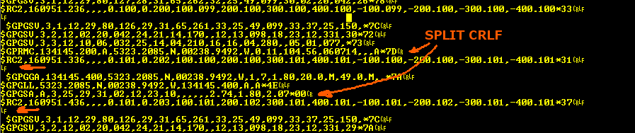

When writing to SD3 from 2 threads (main+worker) ( with binarySemaphore protecting access to SD3) the last byte of the previous string gets delayed until after the complete string of the second write.

The attached png shows the serial byte sequence received including the CR/LF being split by the $RC2 string output. You can clearly see the symptom if you look at the $RC2 line in the middle of the image - the CR from the pervious semaphore protected write is there, then the $RC2 string, then the delayed LF from the previous write ).

Re: SerialDriver protected by Semaphore output split
Are you using a version older than 2.6.5? if so you are probably hitting a bug in serial driver fixed in 2.6.5.
Alternatively, is your semaphore initialized to 1?

Hi - I'm using Chibistudio Preview - latest, so yes, 2.6.4 (but I think it may have been an idiot coding issue - not 100% sure just yet, but have managed to make it work :-)).
Please update to 2.6.5, just replace the chibios directory with the new one.
