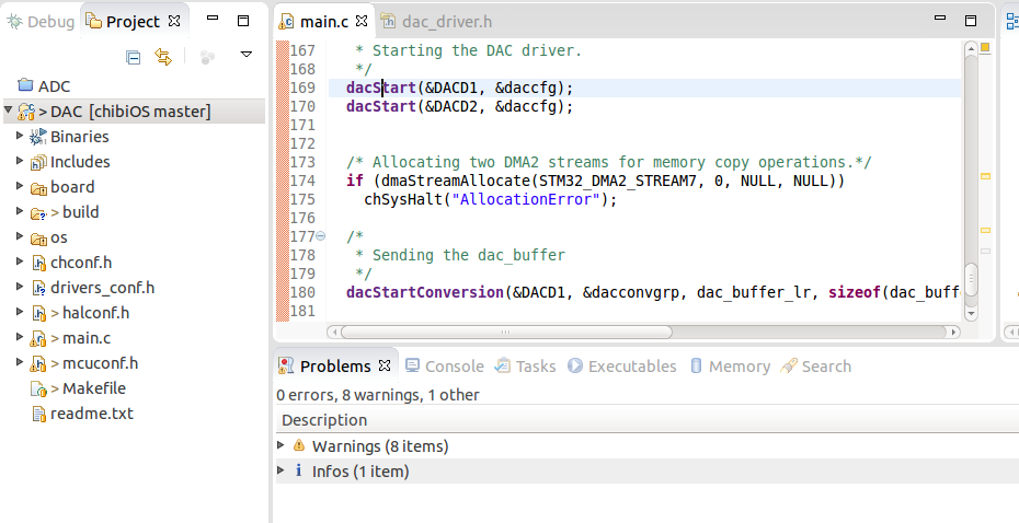

As Giovanni and you sugguested, I have add the driver-path to SRC and INC in makefile and included the header drivers.h in my main.c. Although compilation generates no error, I still could't get my dac on STM32F4 to work. There's one wired thing that the dac_driver.h doesn't seem to be linked to the dac_driver.c.
Usually after compilation, we could access variables and functions declaired in other .c files using F3. But when I tried "open declaration" for the function dacStartConversion in the snapshot below.
It jumps to dac_driver.h instead of dac_driver.c. Trying "open declaration" for the function dacStartConversion in dac_driver.h does nothing. If this function is not linked to the real declaration which has contents in dac_driver.c, then it will a void function and nothing is excecuted.
I was confuced because and I do have the dac_driver.c specified in SRC of my makefile. Do you possibly know what I may have done wrong? I attached my main.c here.
DAC.zip
My DAC project
(4.87 MiB) Downloaded 523 times
PS. Warning messages are attached here. Don't know if they are important.
