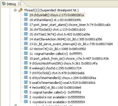

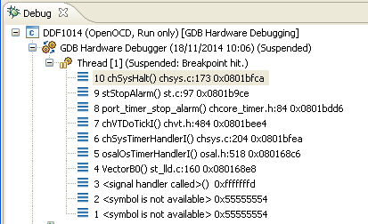

I've attached some stack traces taken with delta=10 which might give a clue.

The I2C driver seems to be always involved somehow but it does not look the regular one, are critical zones respected in that part of code? is the I2C interrupt priority below the kernel level?

I noticed that, as well. In fact two of the attachments (relating to stop alarms) went missing - the I2C driver isn't involved in those.
The I2C driver is the one which supports slave and multimaster mode, originally written by brentr and moved over to 3.x. I've attached it again to save you looking for it. IRQ priority is set to 5.

- StopAlarm2.png (9.45 KiB) Viewed 3802 times
- StopAlarm1.png (9.39 KiB) Viewed 3802 times

Apparently in your application the system tries to activate the ST timer comparator when it is already started or disable it when it is already disabled. This should not happen unless there is a kernel preemption into a critical zone.

Could you try removing this line from line 97 of st.c?
osalDbgAssert(stIsAlarmActive() != false, "not active");
This is probably an error because it can happen that the kernel tries to stop the comparator when it is already stopped. I can't explain the other error, I am still investigating that.
