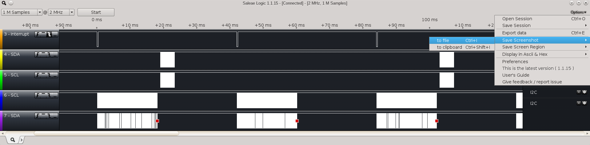

Hmm, no I shouldn't have blocked myself. The code is something like this:
main thread:
lcd thread:
The attached screenshot shows the timing, and I would have guessed that since the main thread spends almost 20ms in transmitting/receiving data that at least one context switch would occur during that time. The bottom SDA/SCL pair are the sensor being read, and the top SDA/SCL pair are the LCD being written to.
Does this shed any more light?
- screenshot.png (70.48 KiB) Viewed 3550 times
